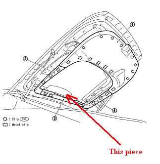

The black plastic piece that covers the 'stop' or 'brake' light.
...or it could be gravel hitting the wheel well

christurismohk, check the plastic around the brake light cover again. The way you describe the noise is exactly what I was experiencing and it was the brake light cover. You can almost reproduce it by opening the hatch and pounding on the glass wifrom the inside, but other than that if you only inspect the brake light cover you will not discover a problem as such. If nothing else, eliminate it as a possibility by shimming it with something. I did, using a plastic "wobble" wedge on each corner and my noise disappeared.
