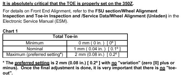

Not sure if this is exactly what you're looking for, but there are some specs in here around page 16 or so. Hope it helps-

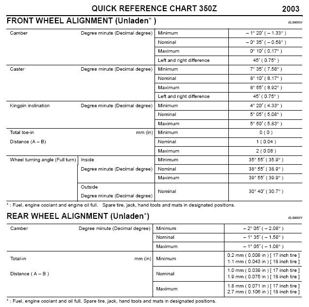

Thank you for your reply. It sounds like the only change is that Nissan now recommends that front toe-in be set to the maximum of 2mm.
My guess is that the alignment specs otherwise remain the same as they appear in the service manual. I have the 2003 manual and have attached a screenshot of the alignment specs. I've also attached a pic of the alignment info from the service bulletin link that you provided.
Can anyone confirm that the alignment specs I've provided are considered the most up-to-date?
