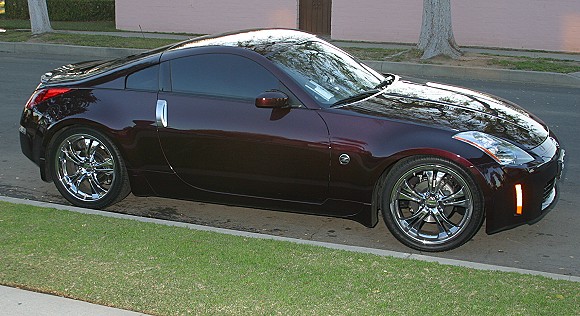

Yes, I hear a squeak coming from rear wheels when I take off Windows have to be down, stereo has to be low, & outside noise has to be minimal, but I hear it. I have taken my car to the shop about 4 times, they have changed the brake hardware, changed the wheels twice, & the other time my car sat there almost 2 weeks with nothing done it. All the excuses that the service department gave me was, the Nissan Tech was gonna call us today, they have to tell us what to do with this problem. They never called. I was also told that there was another Z there(Redline) with that same problem.
Next, I am told that there were quite a few Zs with this problem, so mine wasn't isolated.
Next, I was told that this problem should eventually go away, I really don't think that this is a good answer for me to hear that I should just continue to drive a new car with a squeak that is audible from the outside, & even sometimes audible from the inside.
I have a 6MT Touring model, I notice it when I release the clutch in first & even in reverse.
Has anyone else experienced this problem?
Or maybe even you should listen more closely.

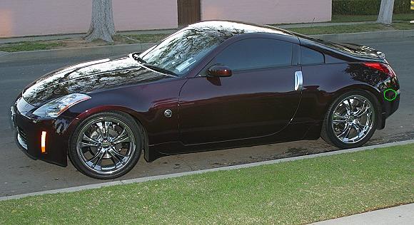

I have a PPW Enthusiast AUTO, I have a squeek also. Mine is definitly coming from the Driver side rear wheel fender/bumper. If I gently press in this area (green circle), I hear an audible squeek. I though it was my suspension as well, but it is definitly the fender/bumper panel.
I am taking mine to Nissan tomorrow to see if they can fix it while it is in for its 1st oil change.
I will keep you posted.
Let me know if anyone else has a similar body panel squeek.
Thanks!

I have the same noise and thought it was the rear suspension loading. Mine sounds like a crinkling piece of cellophane on takeoff. As long as it's just the bodywork squeeking and has nothing to do with the suspension, I'll let it be.

Mine does the squeek noise same spot as DURSO's, I'm sure its the plastic rubbing where it meets metal body.

I had the same problem and fixed it myself. Take your hand and push in on the lower portion of your mud flap/rear bumper this should reveal the squeek. There is a bracket i believe up underneith and all i did was give the bracket a little bend and the squeek was gone. You have to lay underneath and just keep pushing till you isolate were the sound is coming from exactly, once you locate it you'll see what i mean by a little bend. Hope this helps you out.
