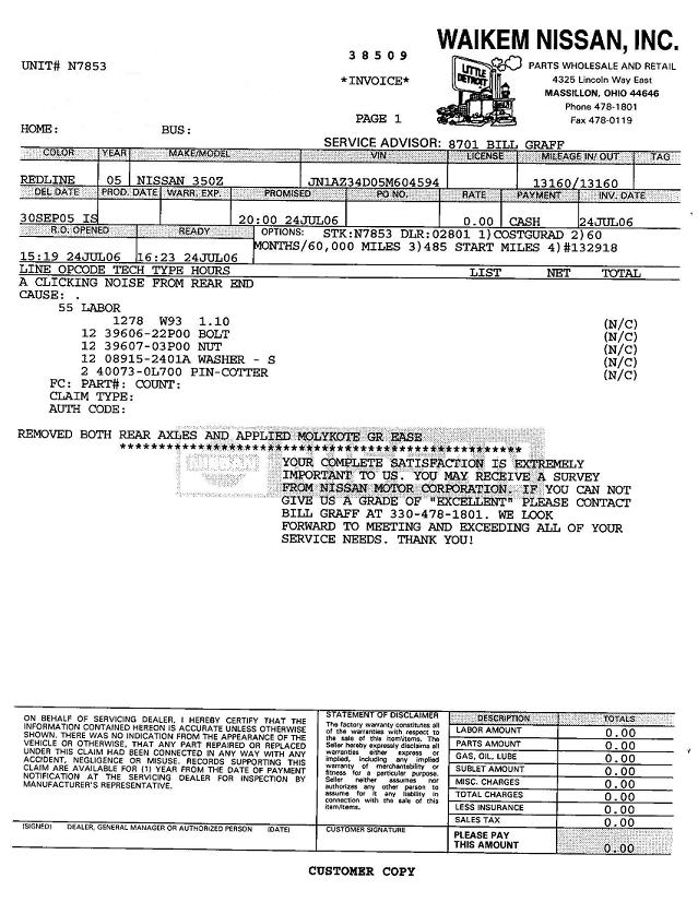

Default Service Sheet
Here is the service sheet to let people know what they fixed and replaced.
Attached Thumbnails Bad clicking noise when take off and slow down-service.jpg
Thank you SOOOOO much 1FlyZ & DavidV!!!! That really helps!!!! When you actually print comes out much clearer than on the screen!! Awesome!!! Any info I get my hands on about what people have done to fix their Z's axle problems is gold!! So I can shove the info in front of Nissan New Zealand. Thank you!!

Huge thanks to Fly & DavidV for emails of the invoices you sent me for the work Nissan did on your axles.
Each invoice has a different comment that has been extremely helpful as we're going throught the technical data and workshop manual.
Does and this a big ask anyone else have a copy of their invoice for axle work done on your 350?? If so please send me a pm.
The more comments on the invoice the better, especially if it has been a more servere case of axle clicking or axle damage full stop!!! Just gives me more ammo to hit Nissan NZ with.
Thanks heaps!!!
