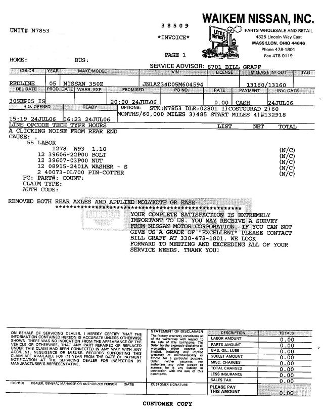

here you go. just got mine fixed yesterday..
Attached Thumbnails Bulletin or Official Nissan techy data re Axle problems-service.jpg

Originally Posted by DavesZ#3
I think only a dealer can get access to official TSBs. That's about as official as it gets unless you can find somebody who has scanned and posted the real one from a dealer.
Thank you for that DavesZ, you've all been really helpful!!!
I more ammo I have to shoot at Nissan NZ the better.
