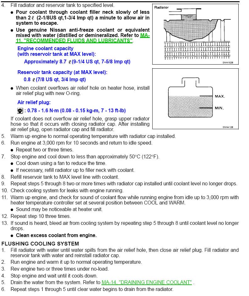

Attached Thumbnails How to Change/Flush Radiator Coolant?-coolantchg01.jpg   How to Change/Flush Radiator Coolant?-coolantchg02.jpg   How to Change/Flush Radiator Coolant?-coolantchg03.jpg

Originally Posted by Wired 24/7
The service manual states to change the coolant every 60k miles, or 48 months.
For recommended fluids and lubricants in the 350Z please click the link in my signature, for the top 100 questions thread.
I can't see those last 2 pics. The words are broken up. Any other way I could get ahold of those 2 pages?

On page 2, the manual instructs to remove the 3 engine plugs to drain the block and check for contaminents. Did anyone actually do this, or is it a bit overkill? I'd like to skip this step if it's not really necessary.
Another question:
Page 3 step#4...
"If coolant does not overflow air relief hole, grasp upper radiator hose so that it occurs with closing radiator cap. After installing air relief plug, open radiator cap & fill radiator"
I'm assuming this clause means that if the overflow does not occur @ the air relief hole, it is because there is still air in the system. Is this correct, squeezing the upper radiator return hose will force the air out? Is the radiator cap suppose to be closed when you squeeze the hose? The wording on this instruction is vague.
Another question:
Page 3 step#4...
Page #2 ---severe over kill !!! and Page 3 ---keep cap closed if you have to tease the air out of the line.....You want the air out the relief, not the open radiator

I finally got around to changing my fluid last week. It was a real smooth process.. I pulled the drain plug. Let it drain slowly. Remember to remove the radiator cap, so the fluid can drain properly. After it stopped flowing, I turn the car on with the heater on full blast, and let the car run for 1min only. About another pint of fluid came out.
After I drained everything I filled the radiator itself, until the fluid began to back flow into my funnel. I then closed the cap and filled the overflow reservoir to it's appropriate level and turned the car on. I let it warm up to operating temp and took a test drive. No problems...
One thing I might add, is I could not find the "air relief hole".. The valve indicated in the service manual is the EVAP valve. I was not going to mess with this. Maybe they have an "air relief hole" on another year/model of Z, but it sure wasn't anywhere on my 2003 Touring model.
I have a 2003 and found it - it does exist. It's near the firewall, kind of behind the engine, you can access it from the passenger side. You'll see a tube running into the firewall, and the tube raises up a bit (for air), and there's a phillips screw-cap on it. When you remove the screw, you should see some green-colored liquid inside (anti-freeze/coolant). When you squeeze ("grasp" in the manual) the tube coming out of the radiator, the coolant will come out of this hole.
