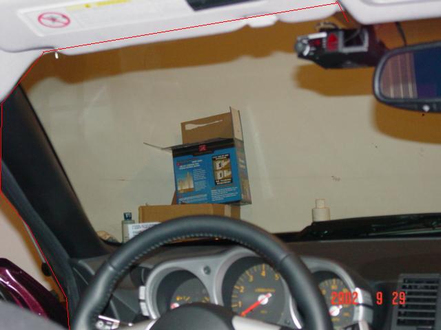

I put mine just below the "dots" around the mirror. The suction cup on the right is stuck to the dots with a drop of crazy glue and the left one is just stuck to the glass. Works great and really not that visible. The red line drawn on the pic is the path I used to run the wires down to the fusebox. I used the cig. lighter fuse so it goes on and off with the key in the ignition.
I think that is how I will mount my V1 when I get my Z.
