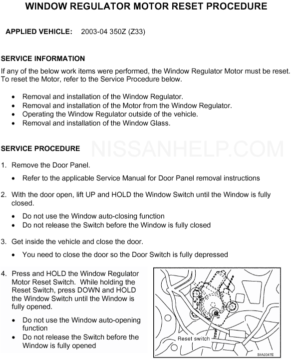

when i try to roll my pass window up it goes up then comes back down half way sometimes. lately its been doing it alot more. has anyone else experienced this too?

Is it an 03? That was a common TSB. Acts like something is caught in it, but doesn't do it when trying it manually. Take it to the dealer.

You can reset the window motor yourself if you don't mind taking apart the door panelling. Search Nissanhelp.com under the Bulletin section for details.
But if you're under warranty still, take it to a dealer. They'll def fix it for ya.

I think the problem wasnt fixed until the 04.5 (made later in the year) so yeah do what the others said and if your under warranty take it in. Its a common problem with the 03's and beginning 04's i think. Ive seen it posted on the forum many times. Maybe try to do a search for more info on it.

Here ya go:
