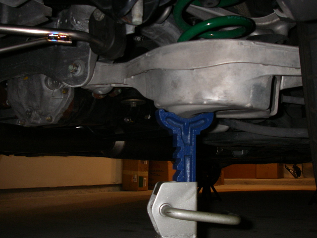

Hey guys, I have a couple questions I want to ask. I just bought a car jack and I'm not sure about where to place the jack. My friend said I need to worry about twisting the frame if I was to try and jack it up along the side frame. He suggested only jacking it up under the suspension points. so there isnt any flex on the frame.

there are notches just underneath the rocker panel marked for a jack.

Welcome. Jack points are in your owners manual.

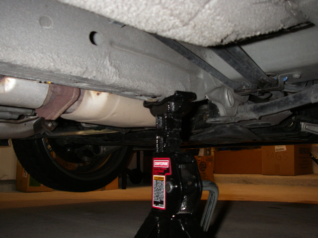

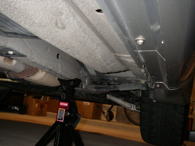

Jack the car up at the factory jack points. You're friend is full of $hit, you won't twist the frame. I've attached some pics of where I like to lift the car. I lift the rear from the differential and place stands under the rear suspension. I lift the front from the beams where the black stands are. There's enough room on the beam to place a jack, lift the car, then put a stand next to it.
