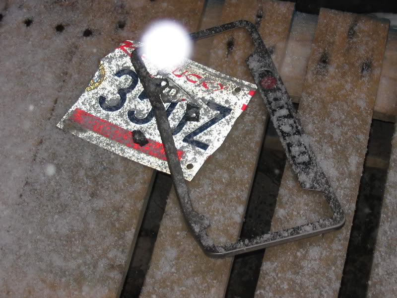

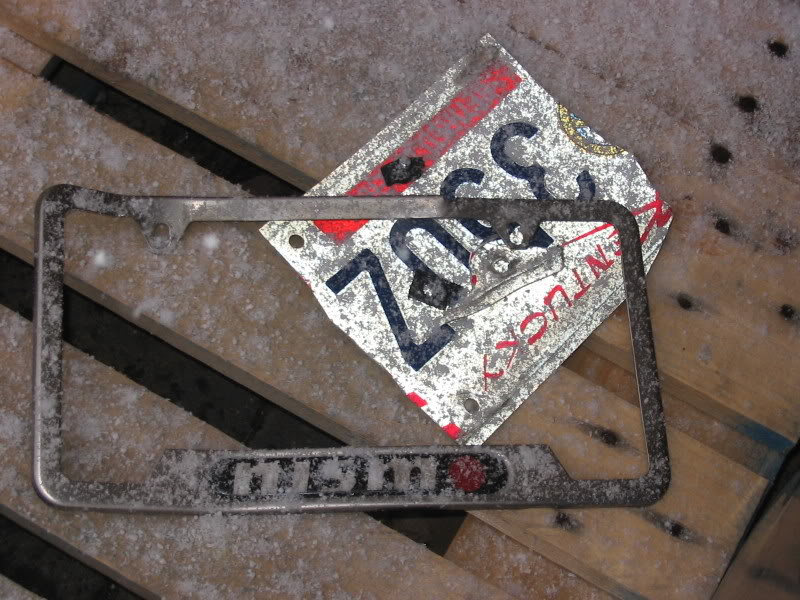

Same thing happened to me a couple of months ago, but both bolts. Ended up using a recipricating saw(overkill), tin snips etc
This is what was left.

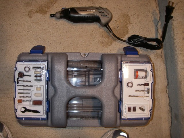

Check out my thread from awhile back..
https://my350z.com/forum/the-lounge-off-topic/201362-look-what-i-bought-last-night.html
Buy one of these. Problem solved....
