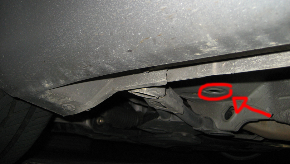

Hi,
recent Z owner and am loving it so far, but i came home today and noticed a heap of water dripping out of the area circled in the photo, it's right near the front left tire (visible in the photo).
coincidently it happened right after i had some issues closing the passenger seat window.
has anybody else had this happen? is it something i should take to get looked at?
TIA

touch it and smell it. Does it have a slick feel or chemical smell?

Its probably AC condensation, if it does not have a chemical smell / feel.

seriously though, sounds like A/C condensation

it is / smells like water..
is this something i need to get checked out?

You could have two possible liquids under the car:
Coolant from the overflow.
Possible condensation from the condenser.
That's it.

Ac!

he says it has no oil feel or chemical smell.
It is nothing to worry about.

Prob. just AC condinsation.
