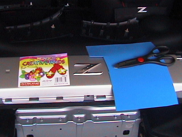

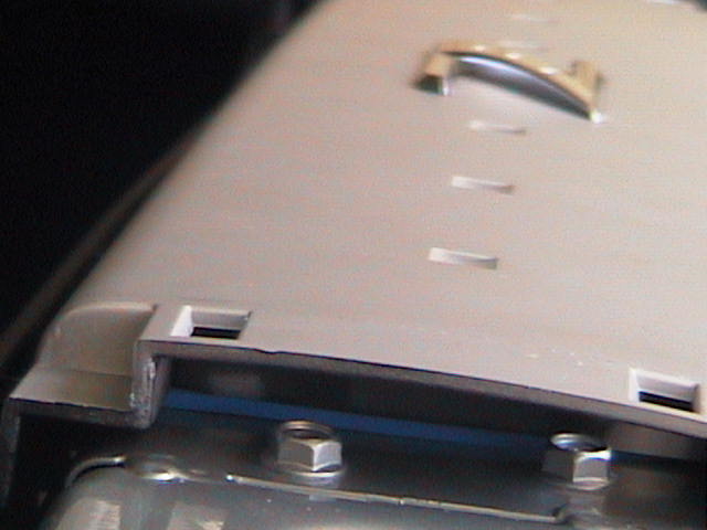

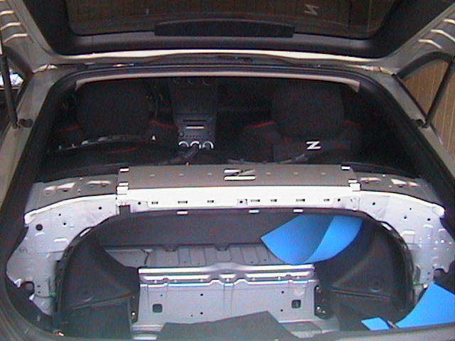

I had the same problem. I had a rattle that drove me nuts. Then once I got the Nismo suspension on it got worse. I would hear a rattle and loud slapping noise every time I went over a bump in the road. I decided to try and fix it myself, and it worked. Total cost to fix was 75 cents. Basically, I just snapped off the plastic parts on the rear strutt and put some thin foam padding that I found at an art supple store called Michaels. I am now rattle and noise free.
Old Jul 14, 2003 | 05:16 PM

Here are some more pics

From: Atlanta
Pics

Getting the p[latic cover off was not very hard at all. I used a screwdriver (very carefully, or else you will scratch the plastic) to slowly and gently pry the pieces off. Whole thing took me about 45 min to complete, and I am now rattle free.
