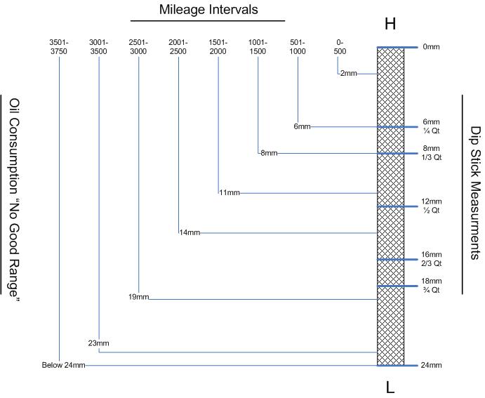

I have made an art out of my oil changes and I can tell you draining 3.5 qts out after 5k miles is normal.
However if your numbers are worse (ie 3k mi) you may want to check for blow by, or a leaking gasket.
As for reading the dip stick, I have attached a Nissan issued chart for "acceptable" oil consumption.
