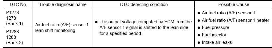

It means nothing, those are from a Ford. Codes over 1000 are manufacturer specific.
Below is the description from the Nissan FSM.

Any suggestions to fixing the problem? Is it worth putting stock exhaust back on to take it to the dealership? I put the test pipes and catback. I really want to avoid the dealership.

P1273
Manufacurer Contrl.
Fuel Air Metering
This could be a bad sensor, a small exhaust leak. This code relates to the upstream 02 sensors...not the ones in your test pipe.
And then again....the mods might just be making your car run a little lean, and its causing this code.
I would definately double check for intake and exhaust leaks everywhere.
The Evap thing is from relocating your evap canisters, and maybe a hose is kinked, or misrouted.....should be an easy enough fix.
