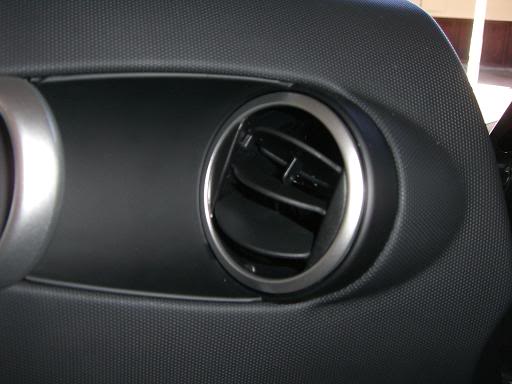

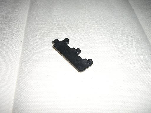

Does anyone know how to remove the vent cover (the one with the fins) from the driver's side door? I think it's part #68761m. A piece that connects the fins together came off and I'm hoping to re-attach it, but can't get the vent cover off to do so. Pics follow.
Here is the vent cover with the fins, I'm trying to remove:

And here's the piece that I need to re-attach:

I'm 99.9% sure you have to remove the door panel. Thay piece screws on from the inside.

Yes, you absolutely have to remove the door panel. The unit is held to the door panel with 4 screws.

Crap, ok - I was hoping it would be easier than having to remove the whole panel. Thanks guys!!

mine fell off too...but i lost the lil bracket. What is the part number so i can order from nissan?

or is there a better place to order from? cuz nissan wants 40bucks for it...when all i need is the lil bracket
