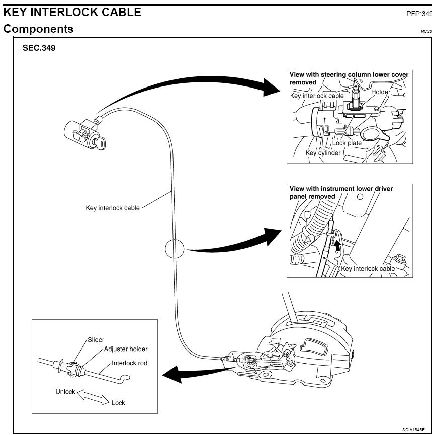

I'd check into the safety switch (or whatever it's called) which requires you to depress your brake to move out of park.

06 has a cable connected between the key and the shifter. Not sure about the 03 but I'm sure it isn't too different...
Attached Thumbnails 2003 350z automatic stuck in park::: HELP:::-interlock.jpg
