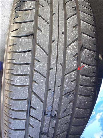

I wondered if this was tire feathering? I haven't noticed any noise except when making slow sharp turns, but most car tires make noise like that. I have little notches out on my tire in the pic below is that normal. The car is a January 03 built with 6000 miles. I could just be paranoid about tire feathering.

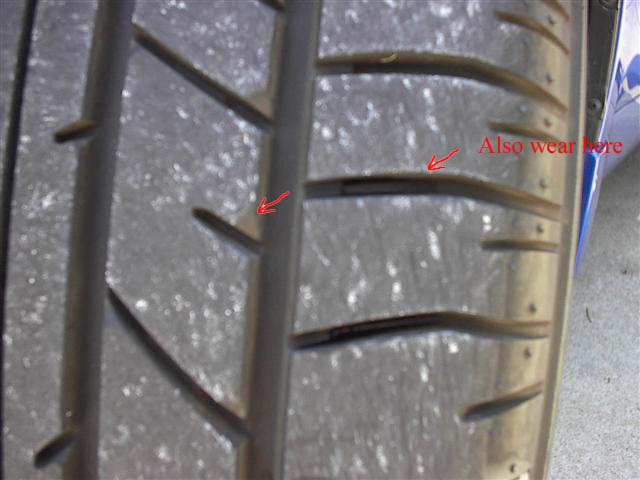

Here's another pic. I have some weird wear on the outer ring, but it's hard to see in the pic.

I think that the feathering is on the INSIDE part of the tread. If you run your hand gently over this band of tread (the inner-most one) you'll feel it. Using the front drivers side tire, run your hand in a clockwise direction over this tread and it should feel smooth. Then run your hand over the same spot in a COUNTER-clockwise direction and it will feel really bumpy. NSANY over at Frenzy described it best when he said it feels like when you pet a cat's fur in the "wrong" direction.

I just started to notice mine at 6200 miles. There isn't any noise yet, but the tire is wearing weird. Also I tried what Dr. Bonz said above and it felt bumpy. I wish there was a fix for this. It looks like there just giving it an alignment and possibly tires. I'm probably not going to take it in till they have a real fix.

The small chips or chunks of missing tread are common with the OE tires. Unlike the cupping ( feathering ) this is not a problem.
