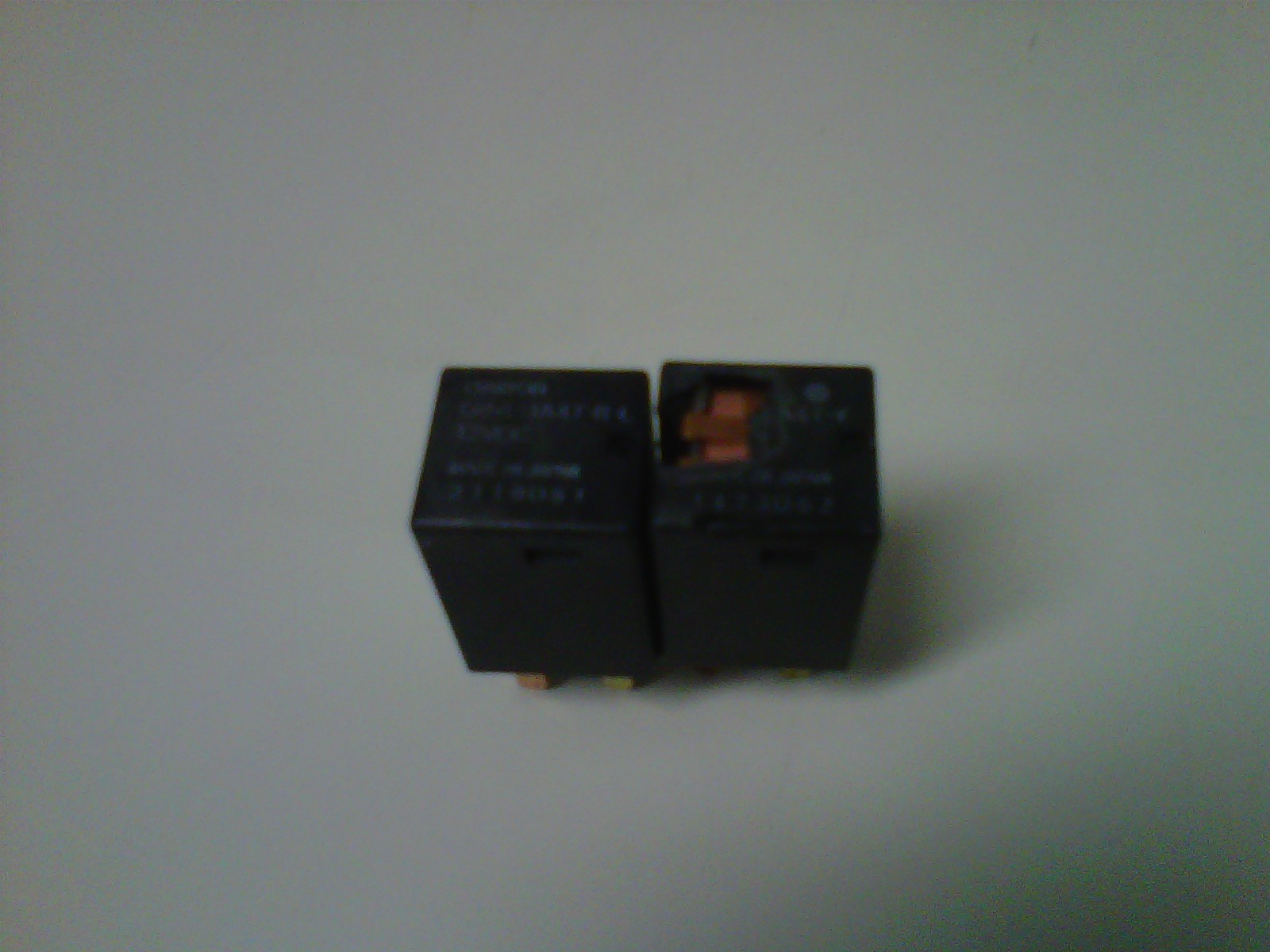

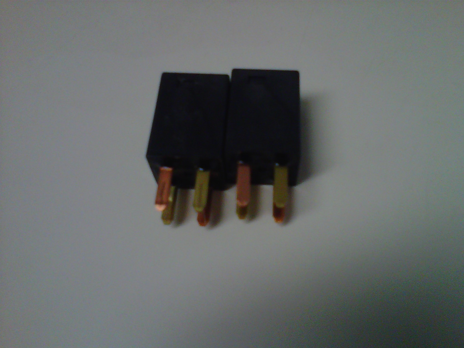

UPDATE: I pulled the a/c relay located behind the battery and the car runs just fine however I now have no a/c.
A call to the dealer revealed that the relay cannot just simply be replaced. Instead, I have to spend $560+ on replacing the entire IPDM (sp?) unit..basically the entire relay/fuse board behind the battery which a lot of crap connects to.
So I research the part (OMRON - Part No. G8VL-1A4T-Y) and cannot find it sold anywhere. I even wrote Omron and heard nothing back. I did however find Part No. G8VL-1A4T-RLDC12 which may or may not be the same since it appears the the former was produced for Nissan exclusively.
I had to stretch the truth and play like I'm an engineer about to place an order for 250 in order to get one sample sent out for $4.75. Please keep your fingers crossed in that this will fix my problem.
If anyone else out there may be in need of one, send me a PM and if it works, I'll try to order some more. Also, if anyone knows how I can get the exact part number, please post.

Well in appearance, the relays appear to be the same. Even if this works, I still need to figure out why the car isn't running properly.

Relay popped in just fine and a/c runs perfectly without the compressor clicking oddly. Also did an oil & filter change (mobil 1) so I know the car is feeling good. The car ran fine during a 20 mile test run. I'll probably need to add some oil when it's cooled off and I can read properly.
