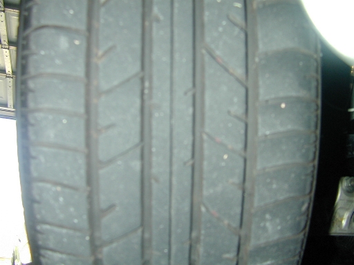

Finally got my car aligned after "Pull to Right" TSB performed. Dealer refused to align it. Opened case with Nissan. I had to pay for alignment, NNA is supposed to refund me. Sure enough, alignment was out of spec.
Toe Left Front: Before -0.08 After 0.05
Toe Right Front: Before -0.08 After 0.04
Toe Left Rear: Before -0.04 After 0.08
Toe Right Rear: Before 0.19 After 0.08
Only 3000 miles on car. Build date: 4/03 Here's a photo of passenger front. Noise level not too loud at this stage.

now tell nissan to give you new tires. Go get em!

wow your garage door is super focused
still watching mines for feathering....

Some of you guys need to find new dealers. I had my alignment done, the service manager ordered me new front tires, and I didnt even have to ask.. Just brought it in for the roaring noise.
