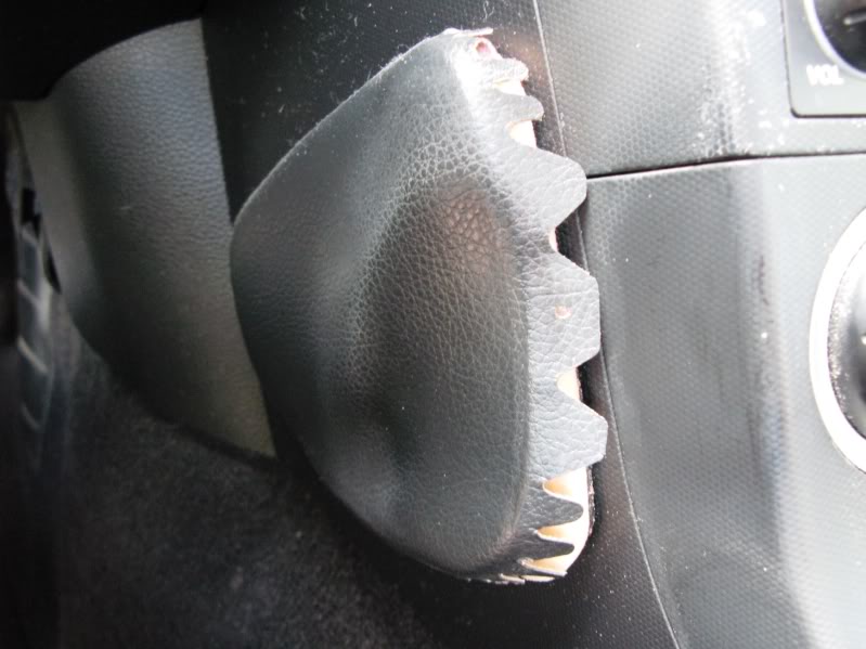

The elbow spot: Can I just buy this piece?

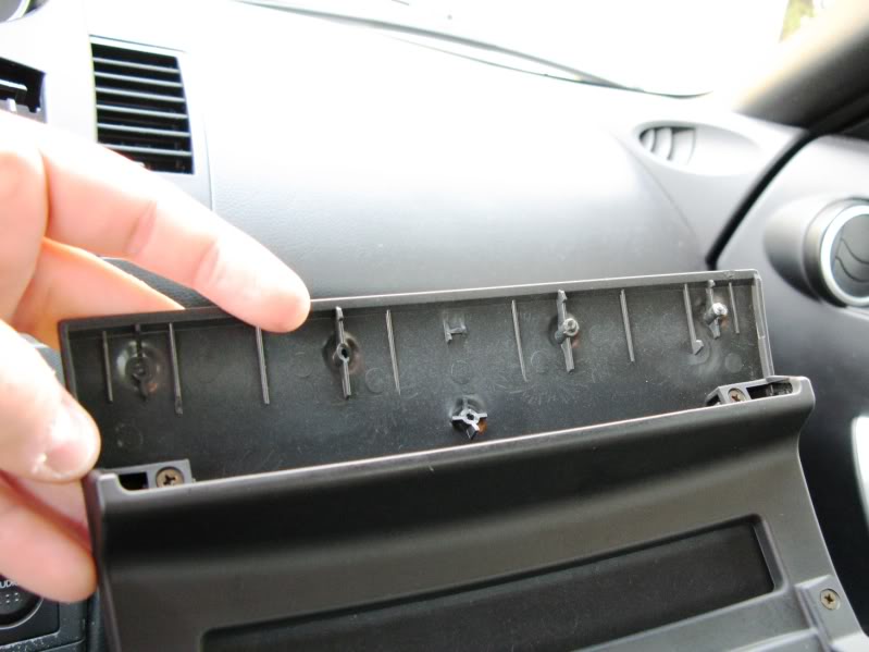

The center console: It appears I can buy just that door piece and attach it back in since the swivel motion thing still works. Where would I find just the door thing?

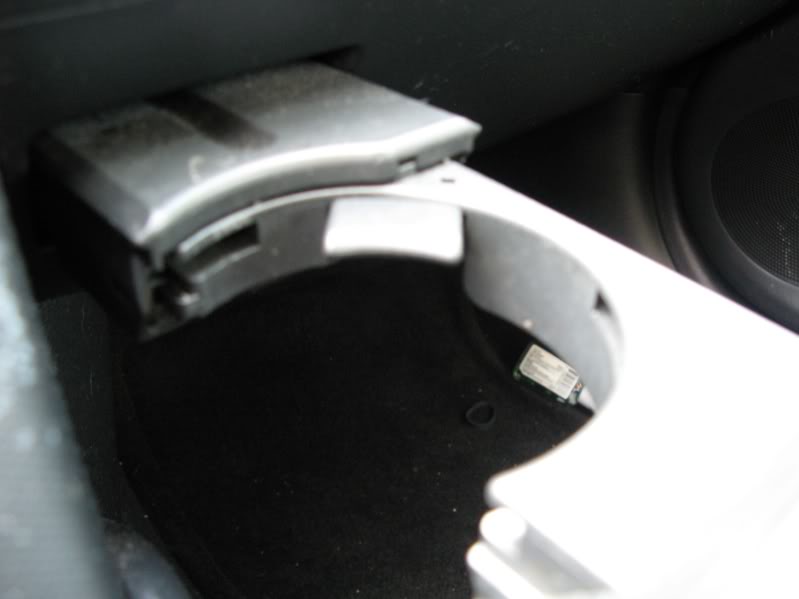

The cup holder: This thing has been screwed for some time but is their any way to fix it?

damn...i have an 03 i've had for years and it doesn't look anything like yours. You sure do have alot of scratches. The door pad on mine has done the same as yours though. I recovered it but i am not happy with how it came out. I'm also trying to figure out a solution. I called nissan and they don't make that part seperate you have to buy the whole damn door panel.

The cubby hole door comes in a whole asembly, you can't just buy the door.

I went to courtesyparts.com to look for the door elbow pad but they don't have it available at least according to their site. Does anyone know how to get a hold of one.

Buy 3 square feet of black vinyl and 3M spray adhesive from AC Moore or some other arts and crafts place, take off the door panel, remove the arm rest and recover it. For the other parts, buy them used.

To repair the door, use a dremel to knock down the broken screw mounts, get a piece of 1/4 inch aluminum stock, cut it to fit inside that area, drill holes through the places where they are needed, glue it to the inside of the door, and run self tapping screws into it through the bracket.
