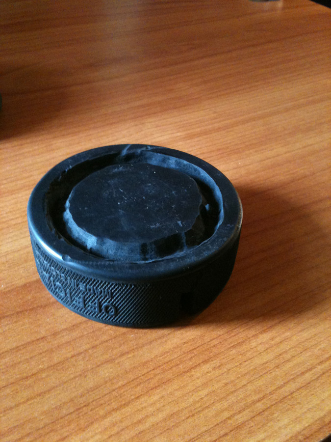

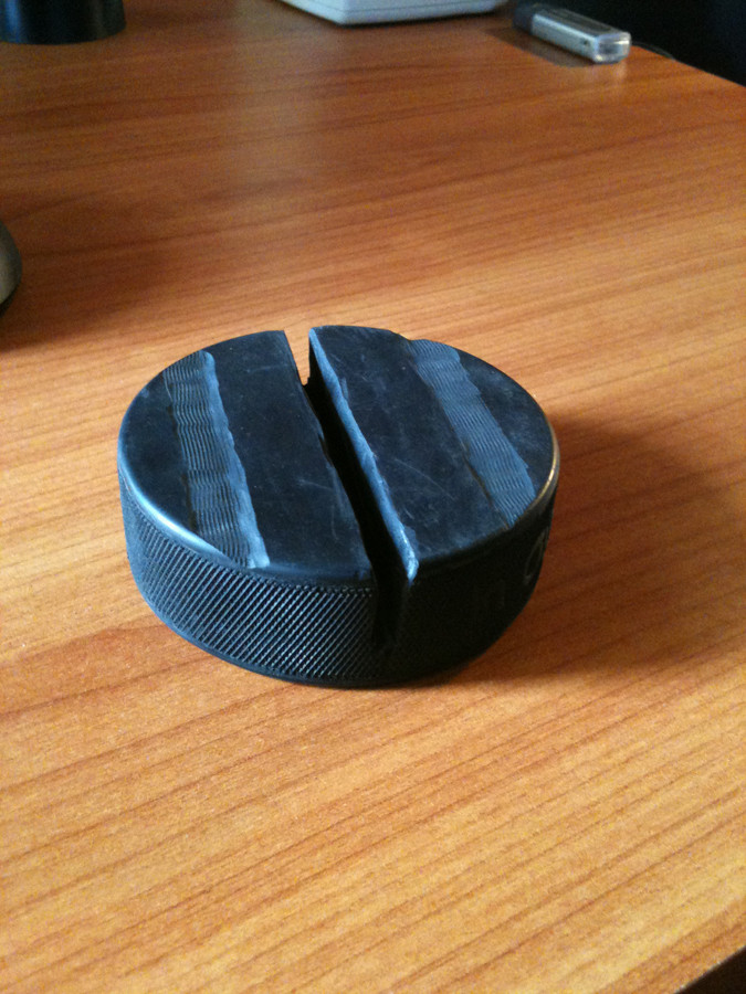

Ended up buying some practice pucks and making the adapters with a Dremel freehand. It was kinda messy and annoying, but the results work.
Pinch weld groove:
Floor Jack / Jack Stand Adapters-s3ikk.jpg
Groove on back to seat into adapter:
Floor Jack / Jack Stand Adapters-liqwx.jpg

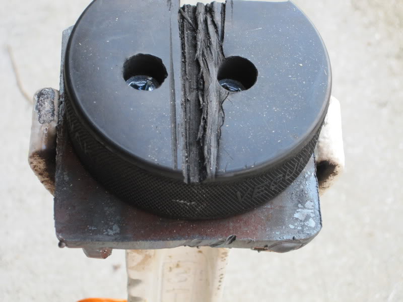

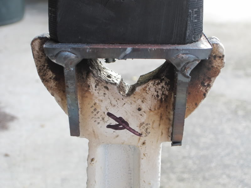

I made some 3/16 plate steel cradles to sit atop the jack stands. I then grooved hockey pucks for the pinch weld and bolted them into the cradles. Works like a charm and cost me $6 in used 2nd handsporting goods hockey pucks.

^ Not asking for a stamped IFC drawing, but how about some pics of that?

Took me about an hour, and so worth it...
