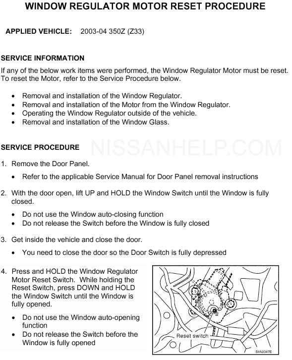

Ok thanks all, this thread came up in a search. I was having the exact same problem for years, that the window goes down 6 inches on its own. I figured this was a 'feature' and just ignored it. However a few days ago it refused to go back up, I barely got it right before a huge storm hit. I googled for 350z window reset like the post above and i found out how to fix it. In case those sites arent around in the future, here's a breakdown

Now you can being the procedure as outlined in the link below. The procedure took all of a minute, really quite easy.
Step 2: Window reset procedure

Ok so I just did the window reset procedure as I described above but now I hear this sound when I close the window. It happens when the window is 3/4ths of the way down. There is no sound when it is being raised up. In the instruction pictures I posted above, it is said to close the door and then continue with the process. I opened and closed it a few times afterwards to make sure that it was fixed. Maybe I closed door too hard? I never forced the window into any position, so I'm not sure what the cause of the sound is.

ok I fixed the clunking. I took the door panel off again, went through the reset procedure several times and made extra sure to tight stuff up again. The one difference is that in my previous reset, i didn't see the last part about opening the door at the end. I did that a few times now the clunking is gone.
