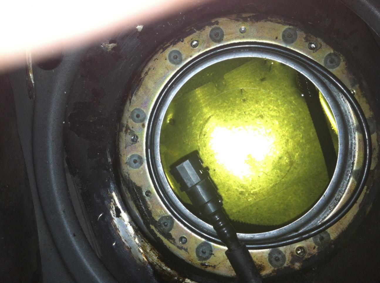

Does anyone have this part its an O-RING

See picture, its the O-RING in the picture

Find a Parker store/hydraulic store, bring bad o-ring (looks to be a Buna/butyl o-ring) so they can match it up with a new one.

No problemo, I use to work in this industry, but just call one of those distributors to see if they or a local shop can help you. Bring your old O-ring for sizing, and buy different sizes/multiple ones just in case the first one doesn't fit. Also pre-lube (vasaline works) O-ring before you install it. Makes mating components easier.

ok tjhanks yeah as you can see in the picture im not sure why the oring doesnt fit anymore? its weird i just took it apart and went to put it back and now it wont go back in. oh well looks like car wont be running until tomorrow!

O-rings stretch over time, they are a PITA to make them stay in the groove.

buy from nissan. its about $10.
It expanded because you let gas touch it.
You can run the car without the oring. dont fill your tank to the top though cause gas will spill out.

Didnt know gas makes it expand they should of stated that in the DIY thread lol... but are you sure it wont leak? doesnt the tank have to be pressure sealed or whatever or ill loose fuel pressure?

I should have thought of that, Buna seals do this when touching fuel.

I drove my car over 100 miles with 0 issues with an expanded gasket squeezed between the bucket and tank.
If you park on an incline or try to fill your tank you will spill gas out.
Car will run.

yeah i cut the o ring and made it fit perfectly hopefully that will hold up until i can order new ones. I went to do the other though and i got no gas on it at all and it still expanded? i dont get it lol... ill go fill my car halfway tomorrow and hopefully my gas gauge will work perfectly now
