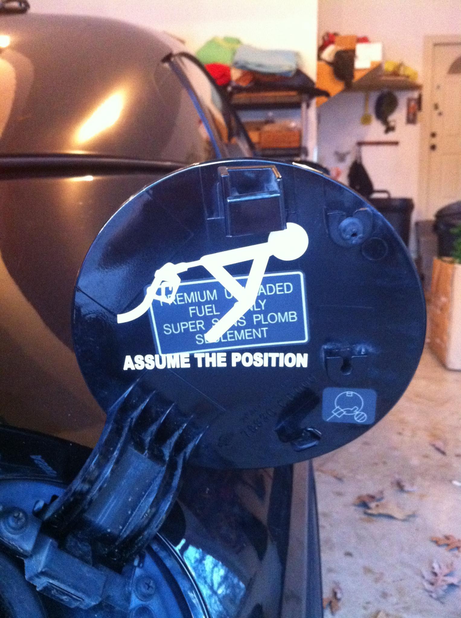

Old Mar 12, 2012 | 10:58 AM
NZMOWND's Avatar
NZMOWND
Joined: Feb 2011
Posts: 2,126
From: Long Island, New York
This is what mine looks like lmao
