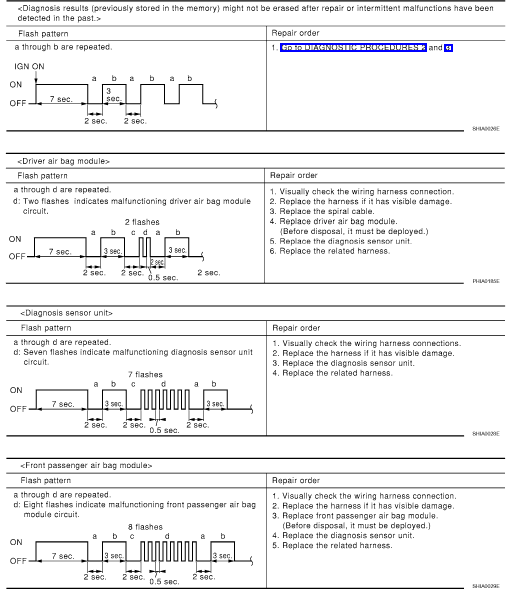

If the light is flashing there is a code.
1. Turn ignition switch from OFF to ON.
2. Within 1 second after air bag warning lamp is on for 7 seconds and turns off, turn off ignition switch.
3. After ignition switch is off, wait for more than three seconds.
4. Repeat steps 1-3 twice. (Perform 3 times total)
5. Turn ignition switch to ON again.
That puts it in diagnosis mode, after you retrieve the codes do the whole thing over again to go back to user mode. Or disconnect the battery, seems faster.
Count the flashes, report back. If the code pops up when someone sits in the passenger seat its most likely the pass seat weight sensor.

No you don't need OEM scan tool. I forgot I was in this thread. Using the method I showed you can get the codes and reset after fixing. Here's the flash patterns:
