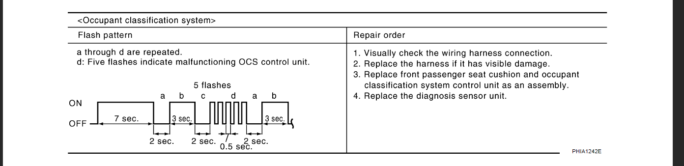

My airbag light started blinking too. I switched the unit to diagnostic mode - it shows error 15.
If I reset it without starting the engine - it goes out on the 5th time. If I start it on the 5th time - it lights up immediately.
Yesterday I got to the control unit located between the seats. I checked all the terminals - everything is fine.
Can I diagnose anything else?
