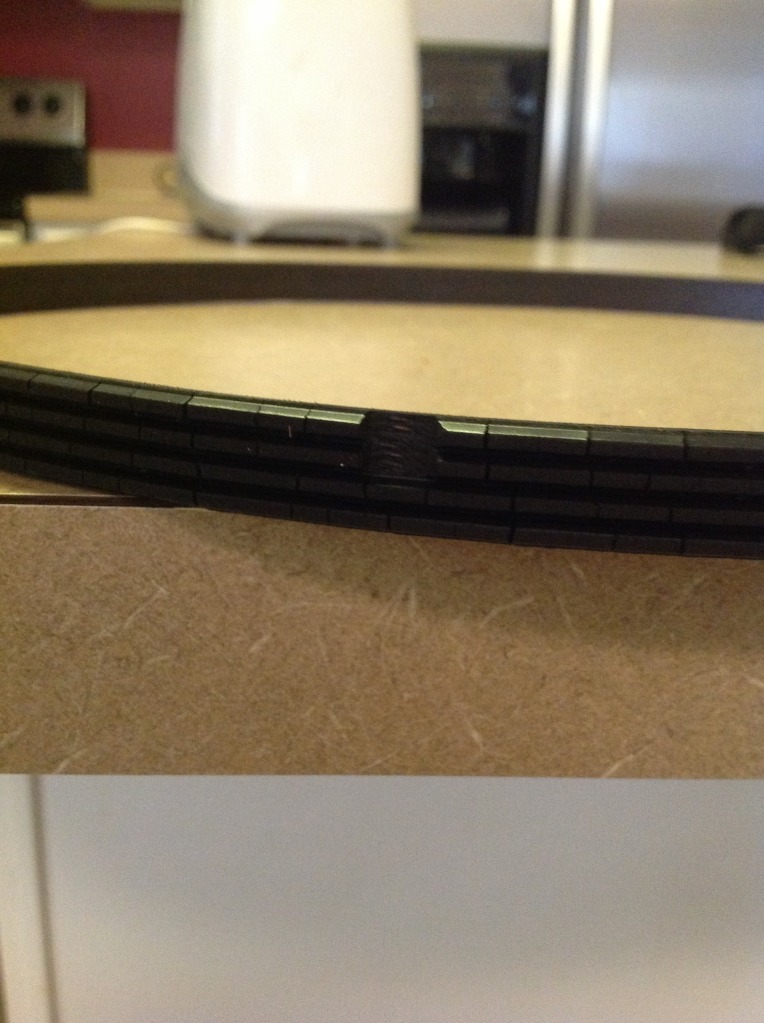

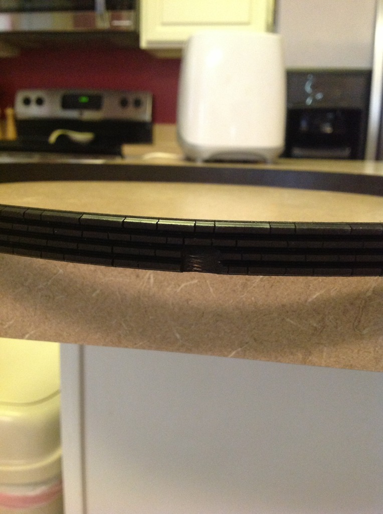

It was an easy job. just finished. Ran into 1 problem. The black metal dust shield bent on me when re installing the pulley nut. Did not sit straight on the pulley and when I tightened it down the nut jammed on the shield and it bent it. The dust shield metal is very very thin and it pinched it enough where the metal broke. So i had a ring of metal around the bottom of the bolt. Tried just using a washer since the hole in the shield was now larger than normal, and the nut would have just spun through. Went to reinstall again and the nut got caught up on the metal ring that was created and wound up stripping the threads on the nut. Thank god not the bolt. Had to completely remove the pulley assembly, and pick away at the metal ring mess of crap I created. Removed all the metal shards and threads that were stuck on the bolt. Went to Lowes and got a new nut. Used a washer and put it all back to together. Easy install but it can be a PITA if you bend that shield.
Pics below of what a bad belt looks like. Replaced it just in time before it went. 2006 54k miles, never replaced the belts before.

@labelworkshop wow I have a 2006 with 54k miles on it and I just replaced mine for the first time as well. My belts looked verry similar to yours as well. Only 1 chip in the smaller belt though. Just a bunch of cracks in the bigger one.
