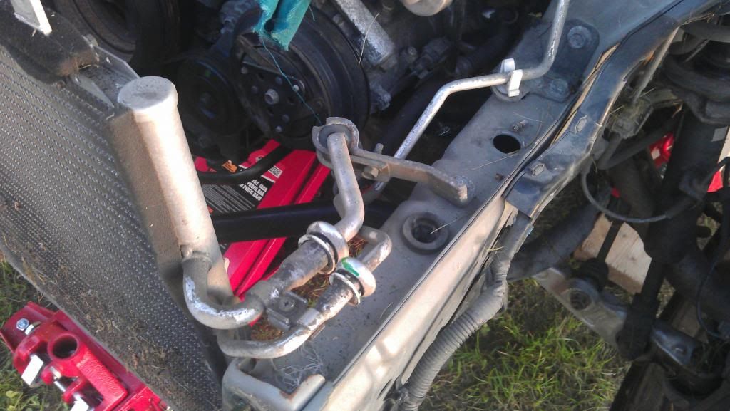

As for the condenser, I don't know much about those to say if the damage will make it not work or not. I can tell you that if you want to replace it you need a special tool to unhook the hoses that go to and from the condenser.
My A/C system blew a hose a while back so I just cut mine off on the condenser side of the special connectors and plan on buying a new condenser and ordering the tool later.
The special tool set is about 45$ online.
The new condenser I was looking at was 120$
This is what the connecters look like -
and the part numbers for the tools are -
