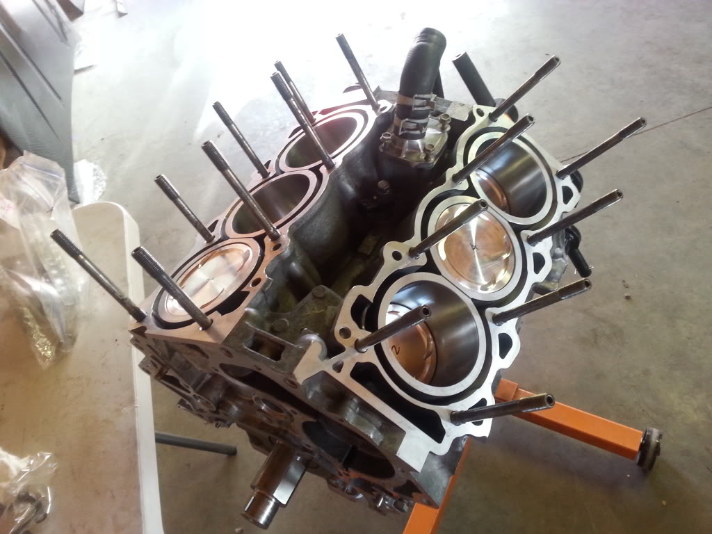

I hate to make this thread...I just got my short block back from forged. Heads reworked locally. Just Put the whole motor together and stuffed her in. I got spark and fuel...she cranks over but doesn't run at all. I followed my Haines manual for timing then manual turned the crank a million times to make sure it wouldn't hit valves. Everything worked before I rebuilt motor I doubt a sensor is bad. Flywheel only goes on one way with down pin hole so that should be right. Any help would be great!

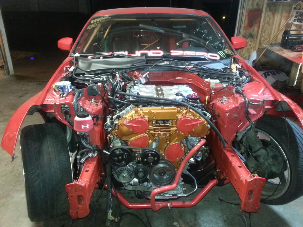

I have my whole front clip off the car. So no radiator and fans hooked up. I dunno if electrically those need to be on to connect a circuit. I just wanted to start quick then shut off.

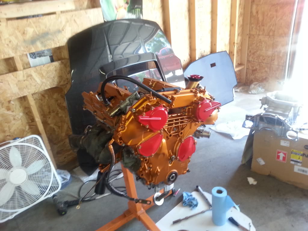

O and if anyones wondering why in my final pics the timing cover isint burnt copper, I'm a big dumb animal and ripped it in half while fixing the timinf issue and had to go buy another one...don't ask..it was late and I was tired and getting grumpy.
