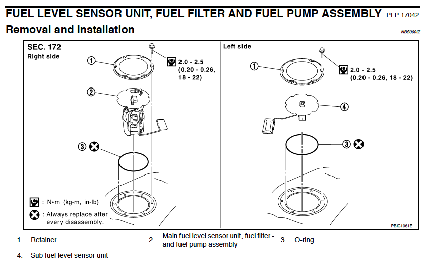

is that the big o ring that is #3?
Ive been looking through the service manual and i followed the same procedures
Attached Thumbnails Car spills fuel before halfway full-screen-shot-2013-08-14-at-11.50.18-pm.png

I replaced the o ring and the fuel filter and one of those seemed to do do the trick. thanks a lot for the help terrasmak, really appreciated.
