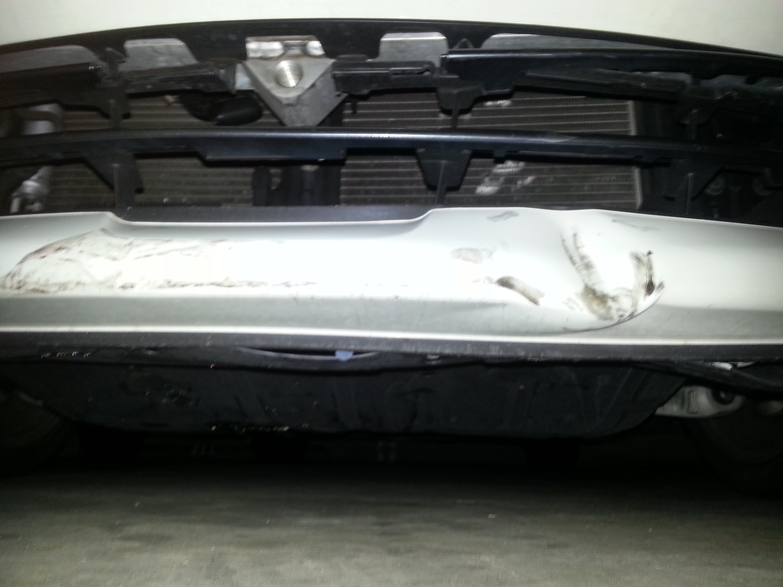

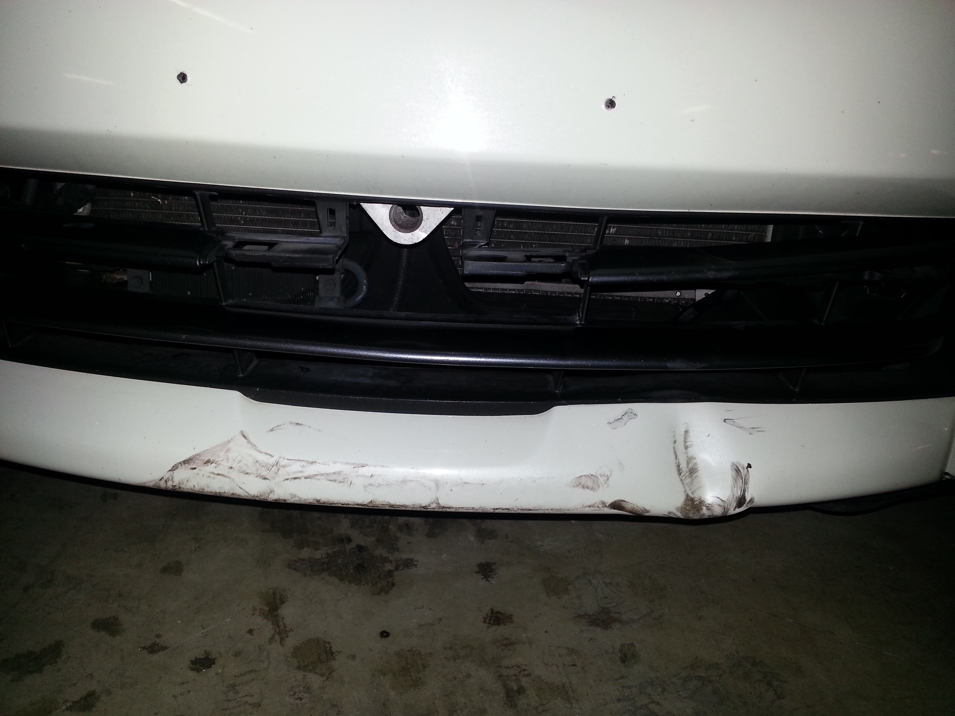

hey guys, so i have an 08 white z and was driving home from work last night. the right lane was closed off with traffic cones and i was driving in the first lane next to it. i wasnt paying atteention and a traffic cone was in my lane and it was tooo late to dodge it when i saw it so i took it straight on..
long story short, i have some minor bumper damage and was looking for advice on whats the best way to go about fixing this..
there seems to be nothing major other than the dent at the bottom, bumper is still aligned well and the undershroud seems okay. it coming off in the front where it attatches though..
should i go for a whole new bumper? and maybe do the aluminum undershround while im at it? or can this dent be pulled and i can replace the middle parts of my grille?(dont think this part is possible from the looks) or maybe anything else i can do to repair at a decent cost..
thanks in advance

Cheap fix.... carbon fiber lower bumper cover---$125.00
Real fix.... possibly new bumper cover plus paint---$600.00
Id clean it up get all the black scuffs off with claybar,,, then pop out the dent as best you can then just put the carbon fiber lower bumper cover over it and be done.

I had a similar problem and bought the carbon fiber bumper cover. Very easy fix and looks great. Get the one from the zstore.com. Cheap and looks great!

not a huge fan of the carbon fiber look but thats def an option, thanks..
and as for the grille part? cause that part got wrecked in the middle too.. hard to tell in the pics but yeaah..

and the grille is part of the whole bumper im assuming? all one piece?
thanks guys..

This should answer your question. Yes, the grill and bumper are one part.

Heat gun and slowly form it back. Wil look better, but not perfect. It will also buy you time to figure out what you really want to do.

Just be careful that you don't burn your paint. I think you'd be able to do a decent enough job so that its hardly noticeable and like Terrasmak says it'll buy you plenty of time to make your decision.

im going to order the middle piece of the grille that im missing and install that. other than that i will work on pulling the dent, cleaning it up and getting the undershroud to sit right (screws are loose)
i also have a family friend in body work so ima give him a call to get an estimate.. most likely ill just live with it for the meaantime..

Advice on the reforming of the bumper is to not heat longer than 20-25 seconds and take the bumper off and do it from the backside so you have less a chance of bubbling the paint. Goodluck.
