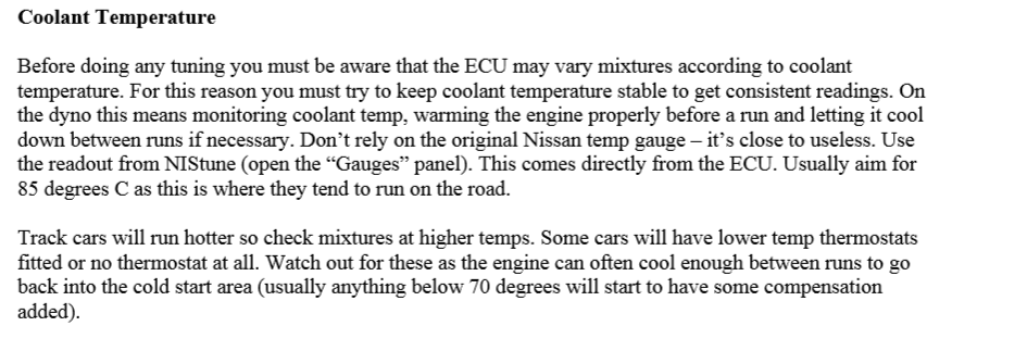

From the NisTune Tuning manual,
85C = 185F, Which should be the normal reading for cruising. Also, I do believe that the performance goes south once the coolant temp starts rising over 187F !!!
