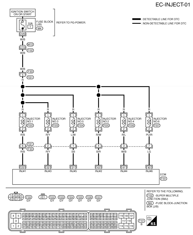

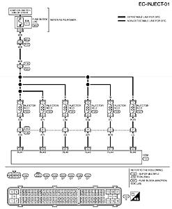

The injectors are connected to + voltage all the time & gets activated by receiving ground signal from the ECU. You said you replaced the injectors & they are fine, So that makes you left with either the harness or the ECU.
Looking at the diagram above, If ECU pin # 41 ( injector 4 ) is grounded all the time, Then most likely the ECU is fried, Use a voltmeter and try to take a measurement as close to the ECU pins as possible.
Good luck,
