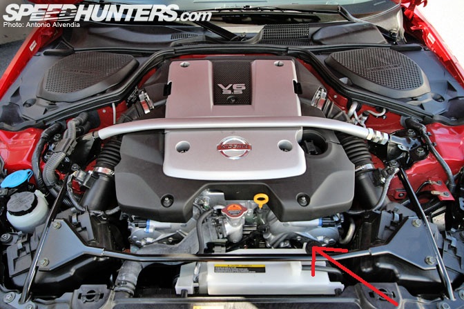

Ok, so the area that the upper coolant hose goes to... is thst the water pump? I felt around with my hand (as I cant get a good look of the area) and felt some wetness. No drips or anything. Just a wet feeling with a bunch of black dirt attached to it. Sorry but on my tablet or would post a pic of the area im talking about.

Here is a picture with and arrow pointing to the area. Coolant reservoir is blocking the view but it right where the upper coolant hose goes to the engine.
