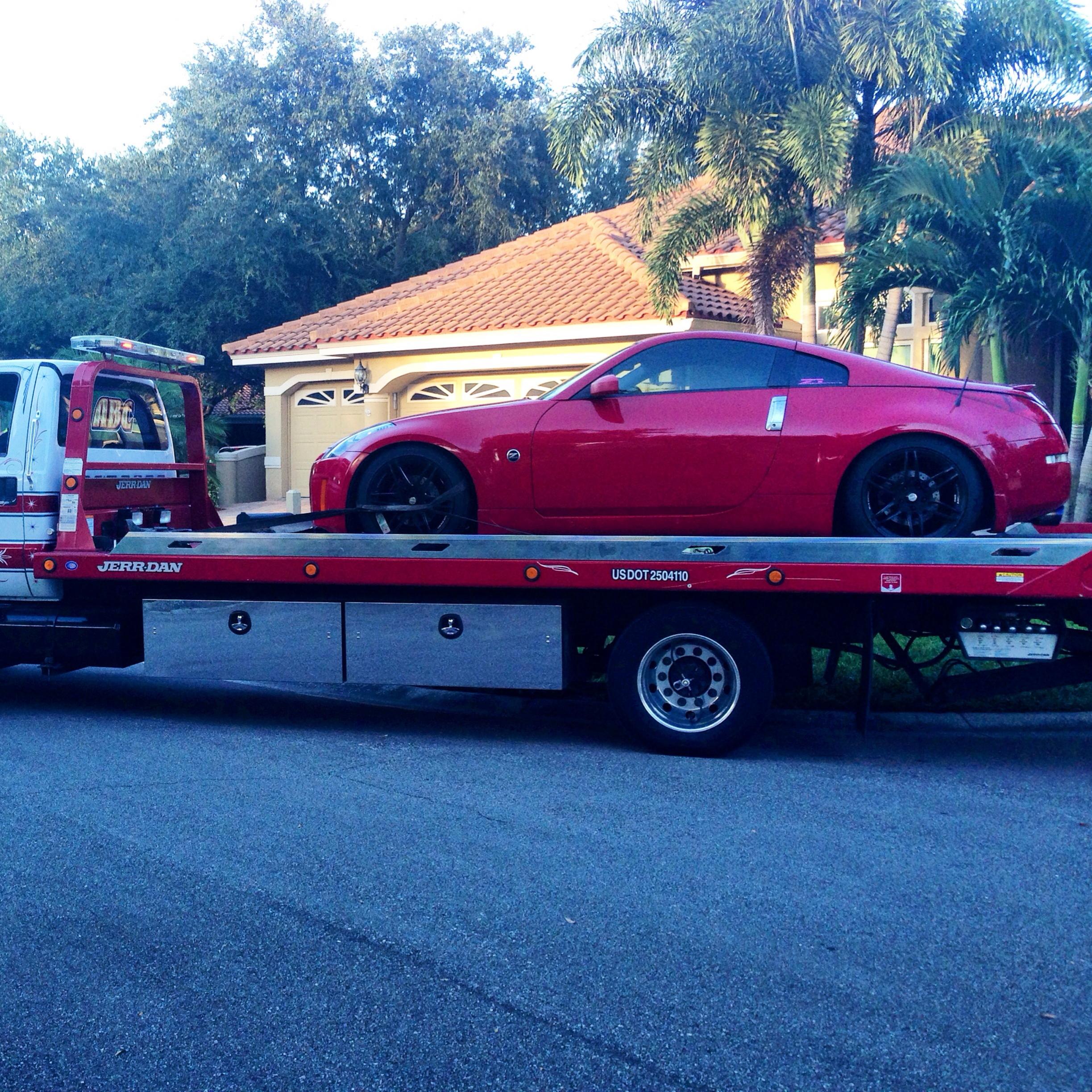

Well my starter is dead, not sure yet if it's related to my gauge problem, haven't had time to look much further into it. Off to the shop for now!

New starter in, car is running. Had a mechanic friend basically take apart my car dash and check all the wiring with a multimeter, he's 99% sure I have a bad AC amplifier, so now I'm on the hunt for a working one to plug in and see if it fixes the gauges, before I go spending money on a new one.
