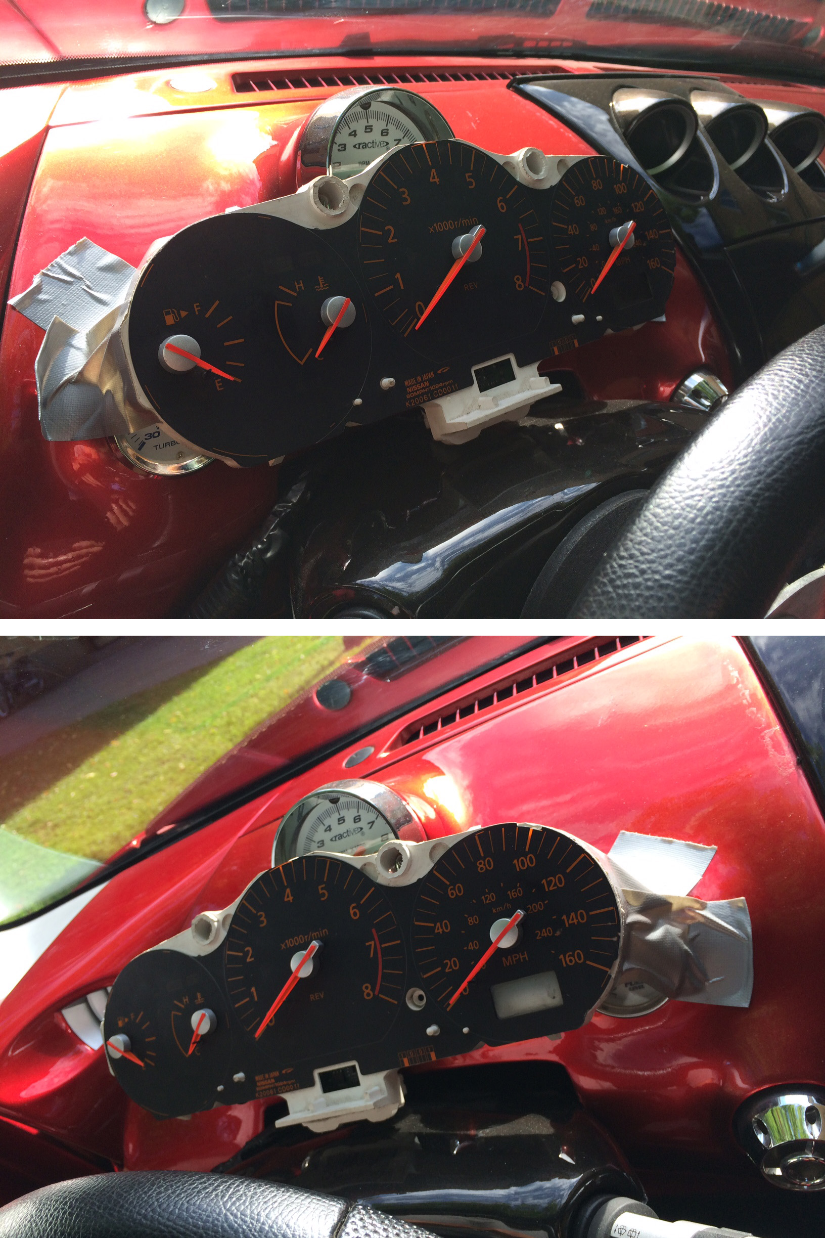

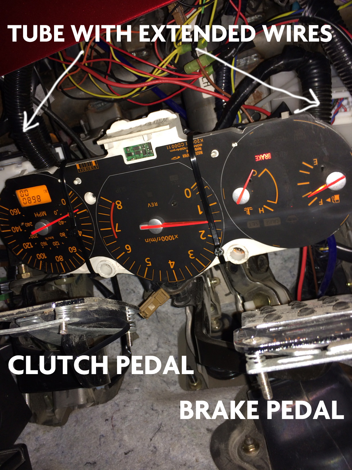

Well, the guy at the shop was down by the pedals and extended some wires to the stock gauges. I know this is probably one of a kind thing, but my Z was built as a show car with custom gauges. But for the inspection I need to put the original gauges in place, temporarily. The original gauges are tied down by the pedals with a zip tie normally.
It's kind of hard to explain, and I bet none of you has seen this before haha... Neither have I, but for me to easily put the original gauges in place, he extended the wires and tucked them in a tube. It all works great, but it was after this that all my mentioned problems occured. I think he must have done SOMETHING to screw it up, but he claims he didn't and takes no responsability for it
I put the stock gauges in place yesterday. Kinda ghetto, I know, haha... But it's just for the inspection of the car to show that no warning lights are on etc. The picture is taken with the phone down on the floor mat, pointing up.
The second picture is how I put the original gauges for the car inspection. Haven't done it yet though, need to fix the turn indicator thing first. Looks kinda good right?! Hahaha...

Interesting.....do I see the word "Turbo" behind the left side of the gauge cluster?
Nonetheless, your problem is 100% attributable to the wiring associated with that gauge cluster setup. If those boxes and wires behind the dash don't play nice with one another, you'll have issues such as yours. It's an unorthodox setup, so it's hard to specify the issue. I'm guessing the original cluster is always working and is somehow paralleled to the custom gauges....? Regardless, I doubt you can get much recourse from that mechanic (not that you'd want him working on it anymore), because there's presumably no known standard to refer to - except that it worked before he touched it.
I'd take this as an opportunity to redo it. Maybe build a matching box to hold the stock cluster in some complimentary fashion with a more stout wiring setup.
Good luck with it.

Haha, yep, but it's supercharged, not turbo charged. So I guess that gauge is pretty out of place... But don't blame me, it was all there when I bought it and I don't really feel like molding a new glass fiber dash so...
And you're right about what you say, there is no reference to how it was done in the first place. I'm not very good with electronics at all, so I just want it to work properly like it did before.
I have booked a diagnose at my local Nissan dealer next week. We'll start with two hours to see if they can come up with some kind of error code or something. Hopefully that will sort it out, but since there are A LOT of modifications on this car, both looks, engine and electronics, I probably shouldn't get my hopes up too much.
