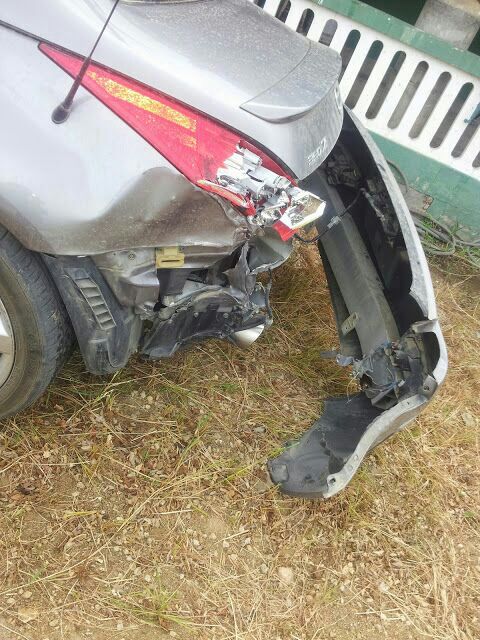

Hi Guys,
I am repairing my other 350Z that has been in a small Accident. It hit the RH front fender and the LH back side as it spun around. Now the driver's airbag has blown. What do I need to replace besides the airbag to take the airbag light out and for it to function properly again? Now we own all 3 newst 350Z's on the island Black '06, Black '07, Grey '07. I have all parts on their way, except for the airbag parts. Thanks for your input guys.

That doesn't look to be any "small" accident IMO! You'll need to replace the front airbag trigger (near the hood latch), the airbag actuator and the airbag itself before the system can be reset. PM me if you're interested in used parts off a pristine '07 ZR that I'm parting out. Here's a link to my FS thread with ptcs:
