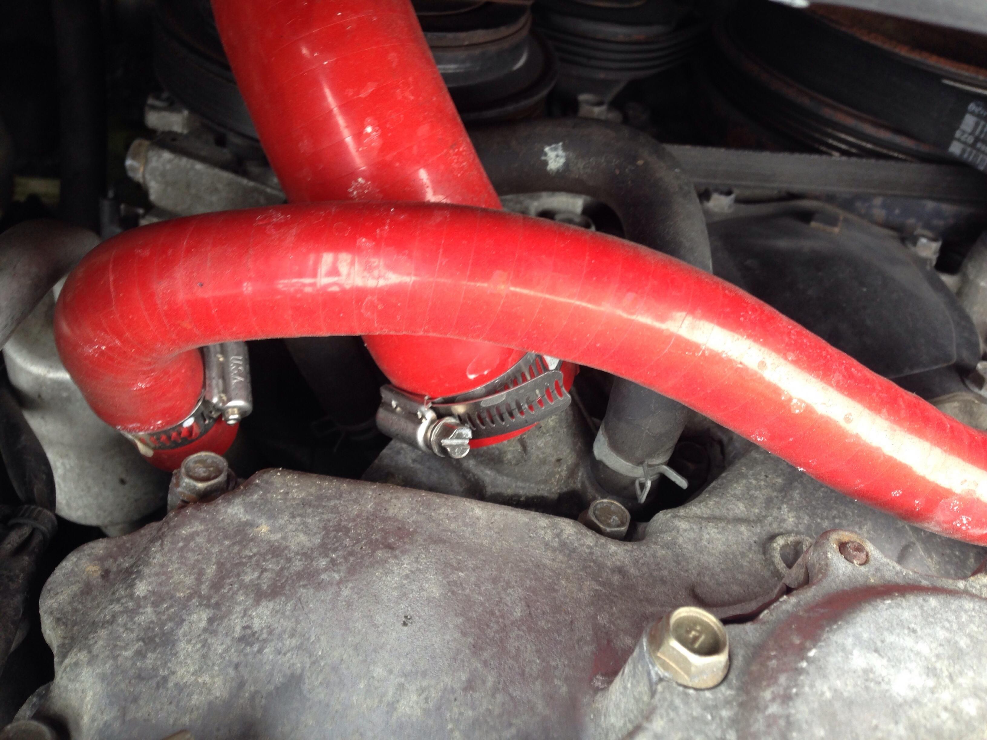

Bealljk- I did that test. The lower hose was cold to the touch and the higher one was reading 200 degrees. So it looks like this guy is my culprit (sorry pic is upside down, when I rotate it it defaults back to this)
EDIT: My brother is getting the thermostat and gasket from Eisenhauer Nissan near us so it will be oem

yeah - that leads me to believe your thermostat is not functioning...
