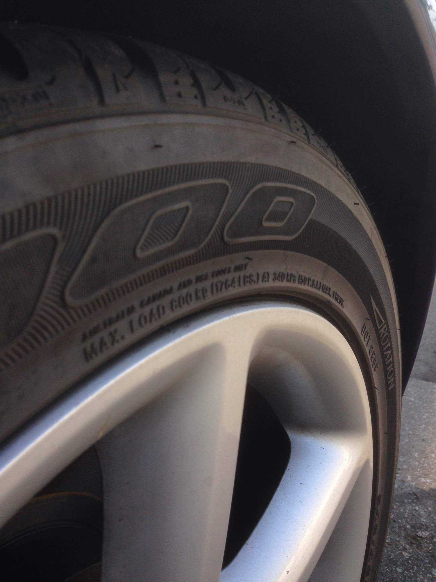

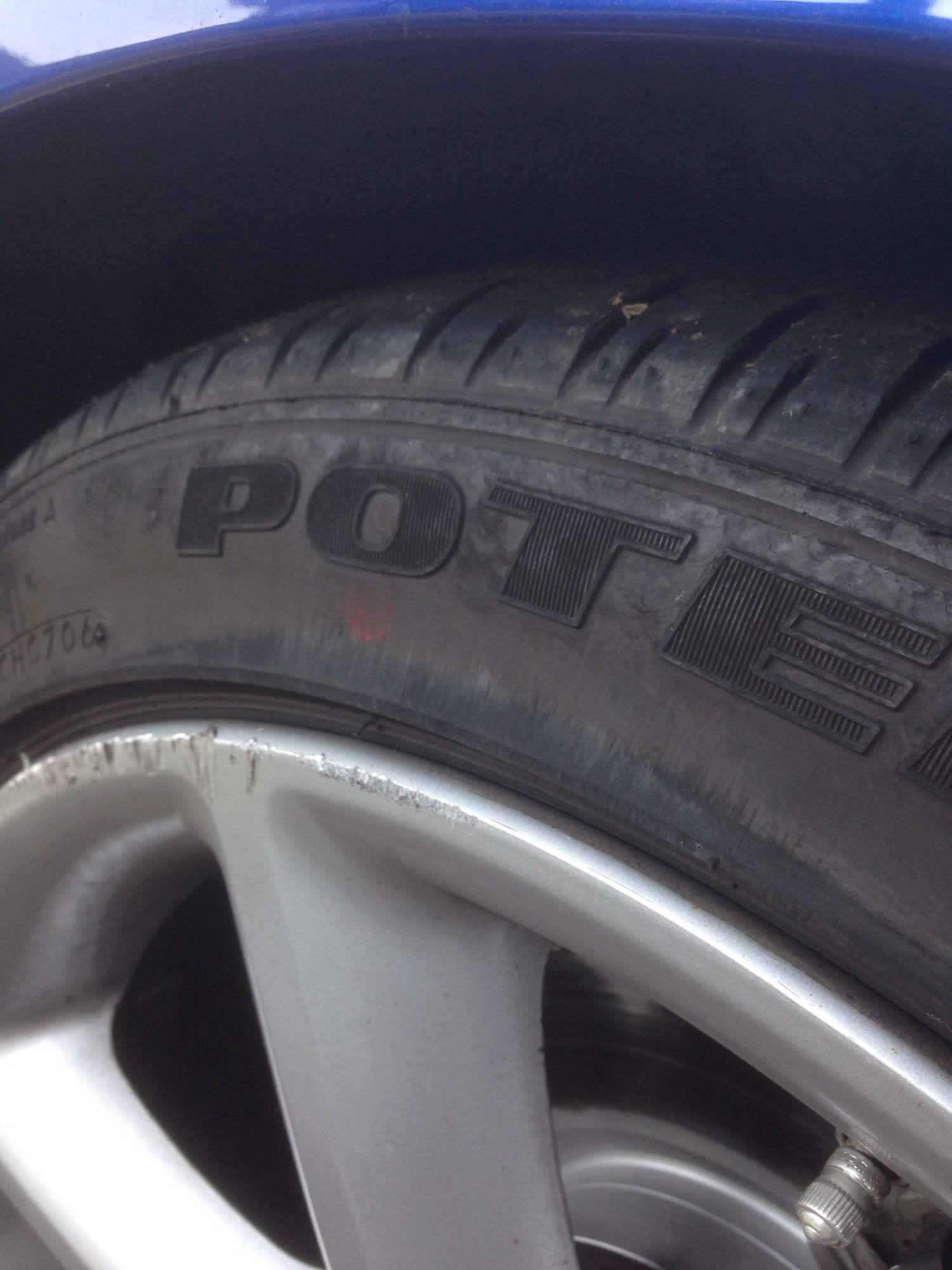

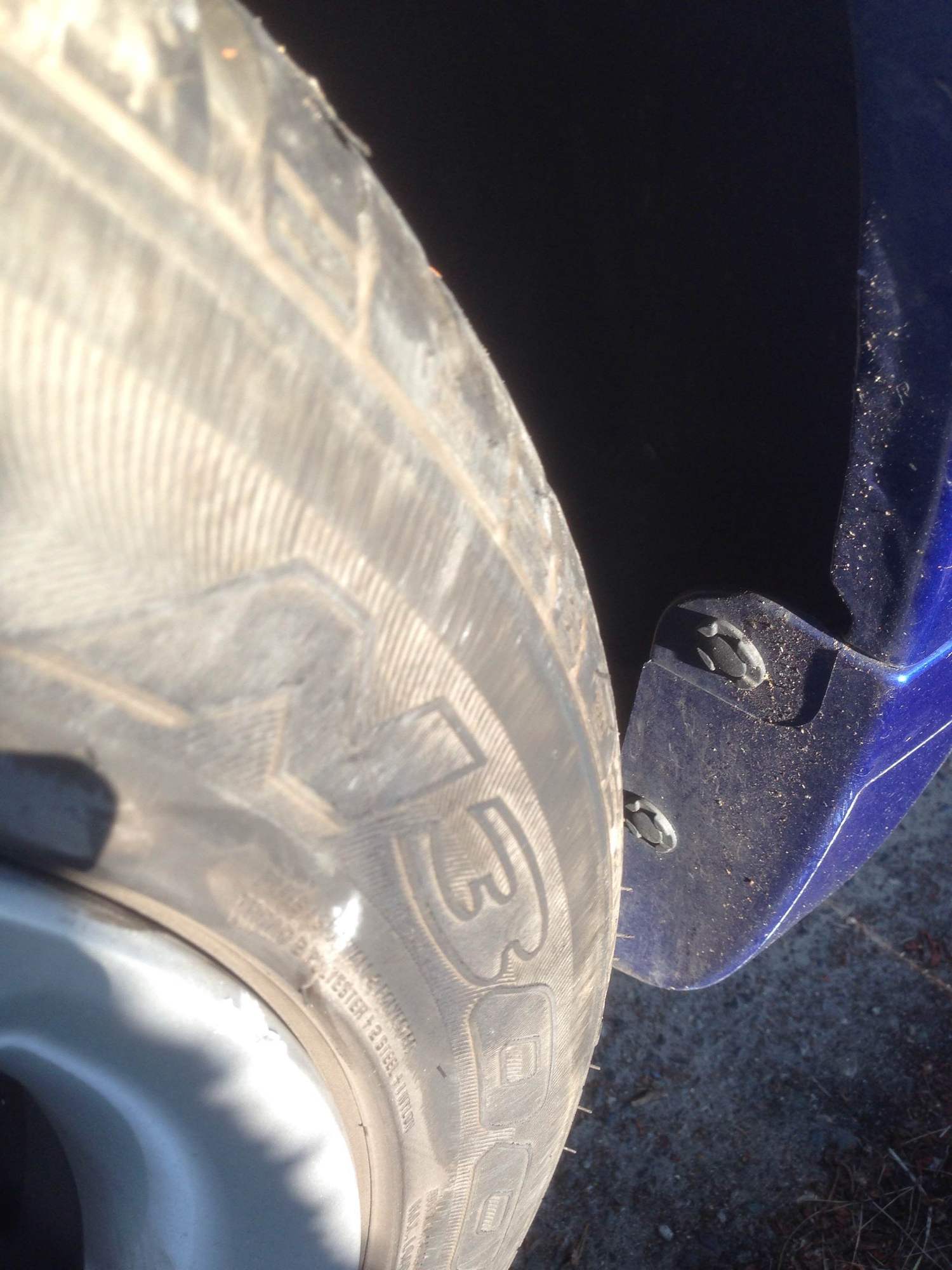

So I took a second look at the tires this morning, and turns out I read the numbers wrong. They were actually manufactured in '07 which makes them 8 years old. Still bad, but arguably not as bad.

Here are some pictures if anyone can point out some obvious signs of dry rotting.

There are lots of articles written about dry rotting tires. Judging from your pictures, I don't see a lot. However, the common theme regarding tire rot or dry rot is that if you see cracks in your sidewalls, you should replace your tires.

Tires seem to pass visual inspection, but I will probably switch them out after summer just to be on the safe side.
