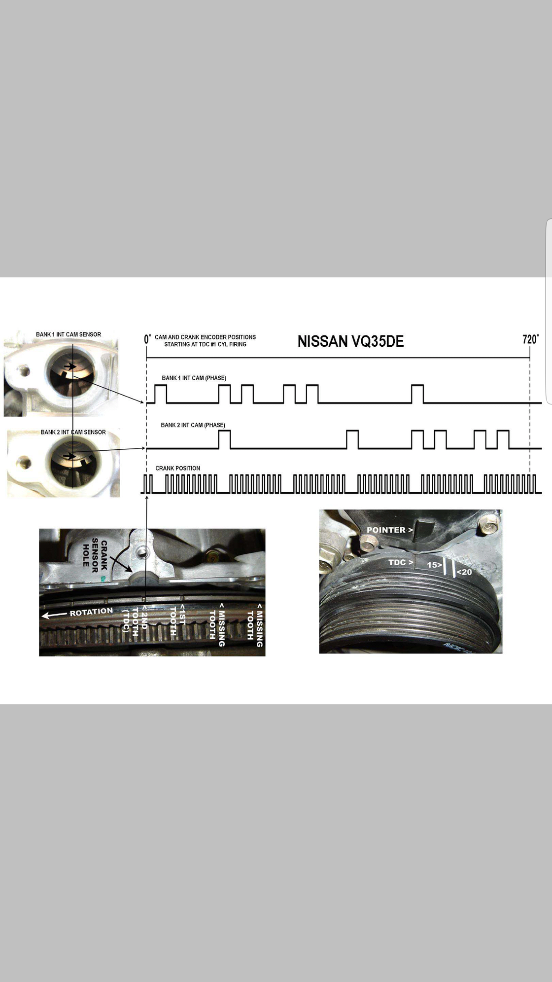

My old engine broke down so I replaced it with a new. And now I have no spark "/ No codes, checked with autocom. I can hear the fuel pump prime and it smells fuel when i crank. Changed both cps sensors to the old ones. Re checked the flywheel. Full battery power and generator is charging. It's not NATS. The check light goes of when I crank. I've tried lock and unlock with the key fob.
The only thing I havent tried is to replace the crank sensor. I only have one of those. Checked the timing with the help of the picture. It looks okay except the flywheel is like 5mm off (metric) wth? Please help

Another thing that gets me confused, is that some say that if the flywheel isnt right mounted the car wont start. And others say it will start but it would run like crap. Wth x)

I have already dropped the tranny twice. I´m 99% sure the flywheel is on right. And I have checked the timing through the hole as shown in the picture i have posted. But it´s like 5mm off. The flywheel is not damaged. The eninge is not damaged.
