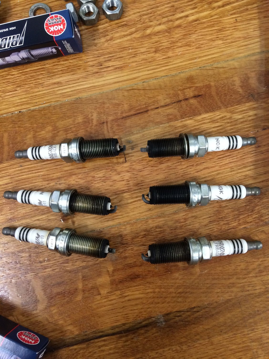

Spark Plugs replaced (passenger side appeared darker)
