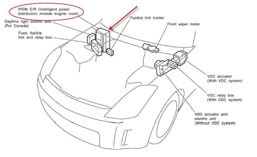

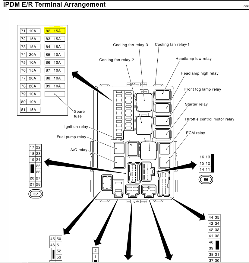

The IPDM isn't the ECU. It's the fuse/relay module under the hood near the battery.
Relays can cause intermittent faults, so check your fuel pump relay to make sure it's still in working order.
