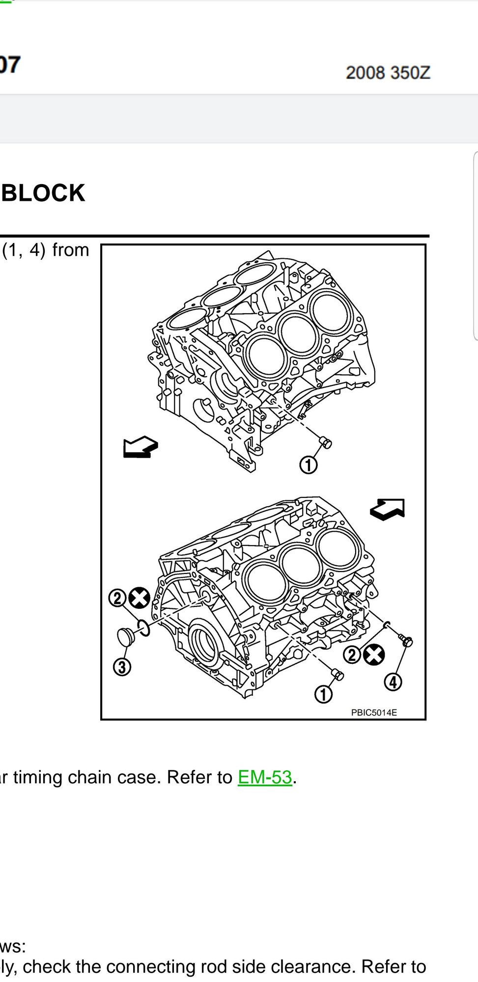

I have an 08 350z (HR) that I'm about to rebuild for the second time. I need a little help with the coolant flush.
Now last time I rebuilt it (for the lovely gallery gaskets), I wasn't sure about the cooling system flush. I knew I had to drain the radiator and empty the reservoir, but as I was taking parts off afterwards there seemed to be a decent amount of coolant left in the piping (one going through the engine attached to the.....filler neck?).
I watched a video where this guy was doing a flush and he took off a cap on the side of the engine that DRAINS ANY REMAINING COOLANT from the engine!
Do our Zs have this cap???
I want to know to completely drain it because after I got her up and running last time (with auto parts coolant), i went to Nissan for a good ol pure flush. It wasn't long ago so I want to keep the coolant and put it back when I'm done.
Thanks in advance!

They do. Reference .7 of the pic

ok so it's only 2 plugs and on the passenger side then, right?
3. 2 on passenger side, 1 on drivers.
Here's a better pic. Numbers 1 and 4 are what need to be removed (2 1s and 1 4)

thanks brother!
