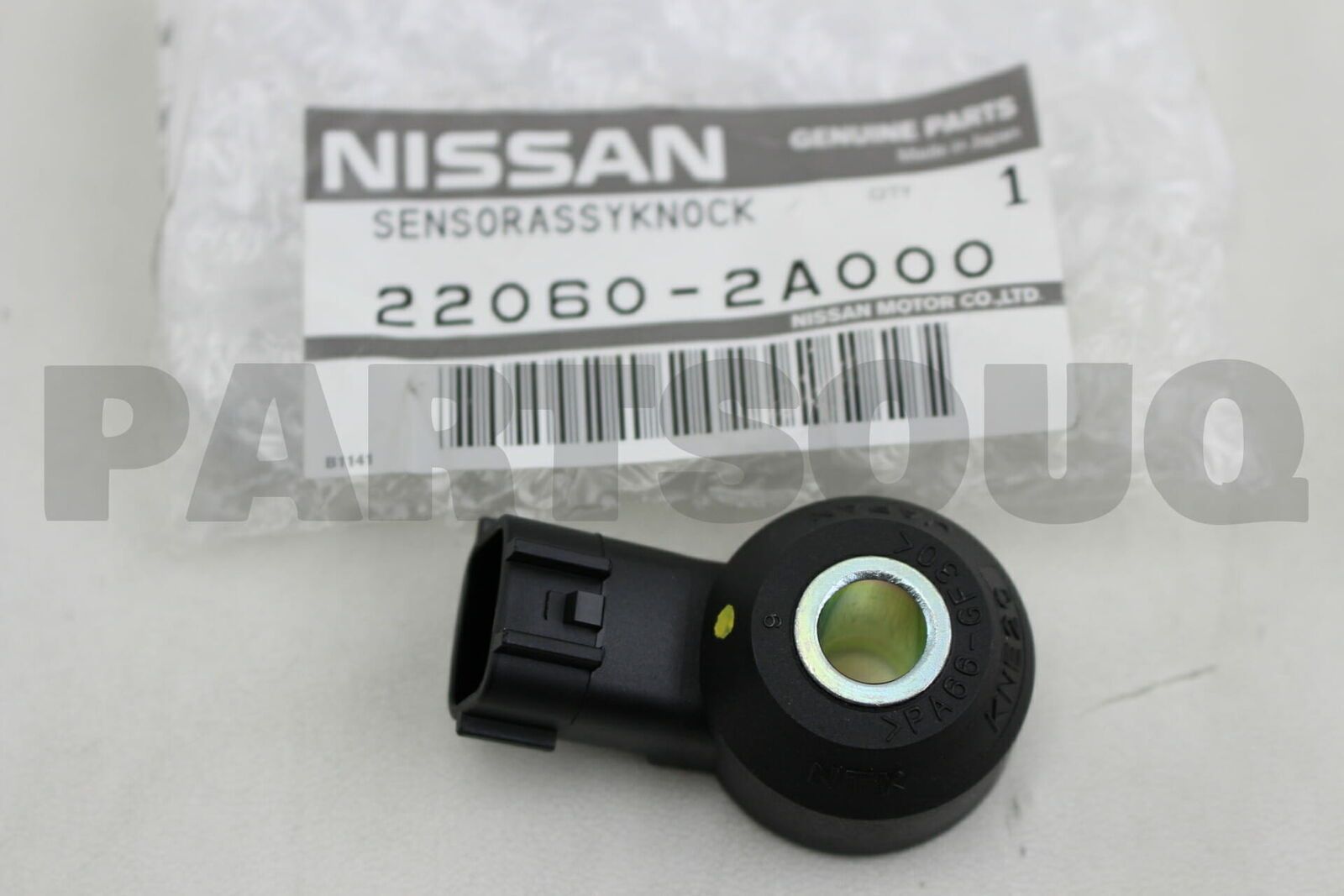

Anyone know who makes the OEM knock sensor?
I'm seeing NTK KNE20 on the ones online.
Should I just buy a NTK from rockauto?
thanks

I went to Nissan they wanted $400CAD
I went to mazda, same part OEM $34
PE0118921

Got the "Mazda" part.
It crosses over to the nissan part and ohms out within spec

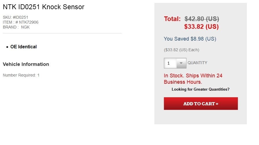

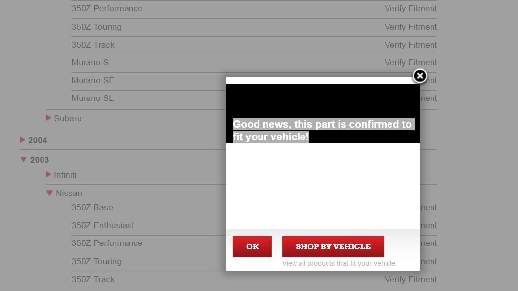

https://www.ngk.com/product.aspx?zpid=61324
Some shenanigans going on with that pricing!!!
Looks like the HR has a different connector with opposite ridges on the sides but anyways....the maza part fits the DE and is an identical part according to NTK themselves
https://www.ngk.com/product.aspx?zpid=61352
