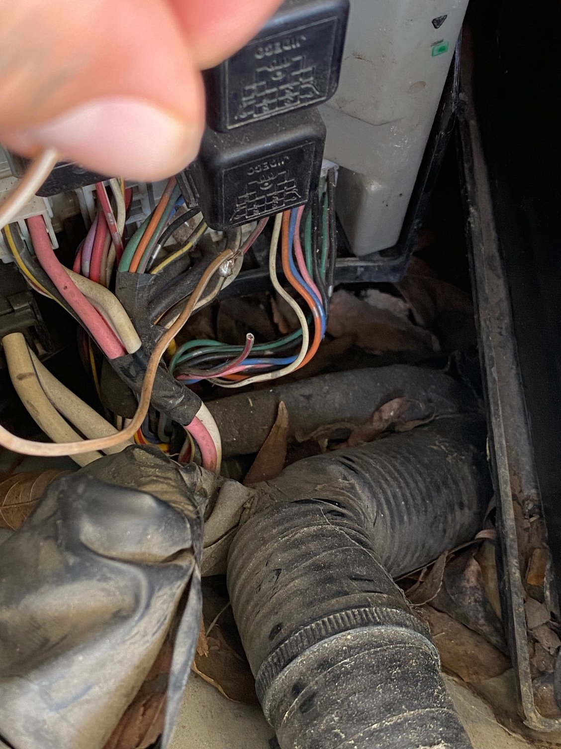

Hey I have an 05 350z that is throwing these codes. This is the first time I’ve come across these codes. Also my first 350z , I’m trying to get my car smogged but can’t because of these codes. Does anyone know what it could be ? The most common ? The car turns on and drives fine, I’m wondering where is the best area to look first. I was looking by the battery where the fuse box is located, because I was told to check for any wires damaged etc etc. I found a wire that was cut that goes to the ecu and ran through a separate wire, but I don’t know what that wire is for, and why it was ran different. So I’m not sure what it’s affecting. Any help would be great , thank you !
Here is a pic of the wire that is cut.

gotta love shade tree fixes... love the blob from a soldering iron just hanging out

exactly. I don’t know what they were trying to do with that. But I found out that wire is for the safety neutral switch.
