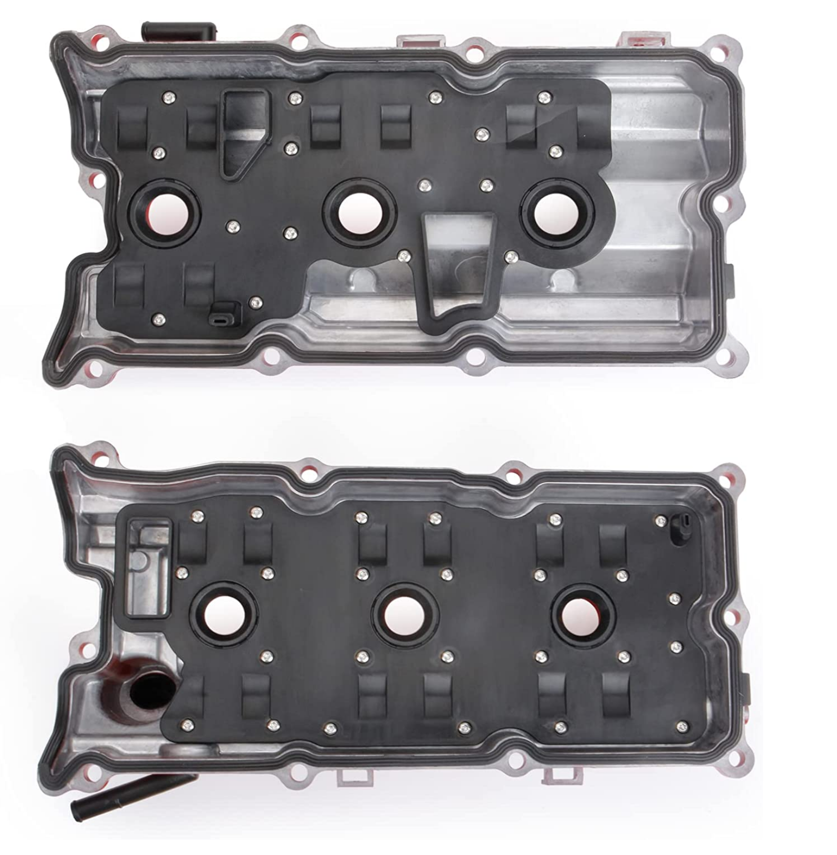

I just installed the aluminum valve covers, last weekend and they fit perfectly. This is the best option out there because the spark plug seals are replaceable and the fitment was spot on. Just like the factory covers you will need to put RTV on the front corners, I also put a drop of RTV in each corner of the cover and then inserted the gasket to keep it in place when installing the covers. The only hard part to the job was getting to the rear bolts on the valve covers. You will need a long 1/4 extension with a swivel joint to get the bottom passenger valve cover bolt. It's a huge pain to get to.

The valve covers had all the necessary holes to mount all of the brackets and harnesses, just like the factory unit. The only difference between the aluminum covers and the factory covers is that the spark plug seals are serviceable and they are secured by the plastic cover on the bottom side. Just make sure to check all of these screws and apply some blue loctite, to make sure they don't back out.

The valve covers had all the necessary holes to mount all of the brackets and harnesses, just like the factory unit. The only difference between the aluminum covers and the factory covers is that the spark plug seals are serviceable and they are secured by the plastic cover on the bottom side. Just make sure to check all of these screws and apply some blue loctite, to make sure they don't back out. Also the PCV valve was damaged during shipping, that was the only part on the valve covers that looked suspect, so I purchased an OEM PCV valve and installed it.
