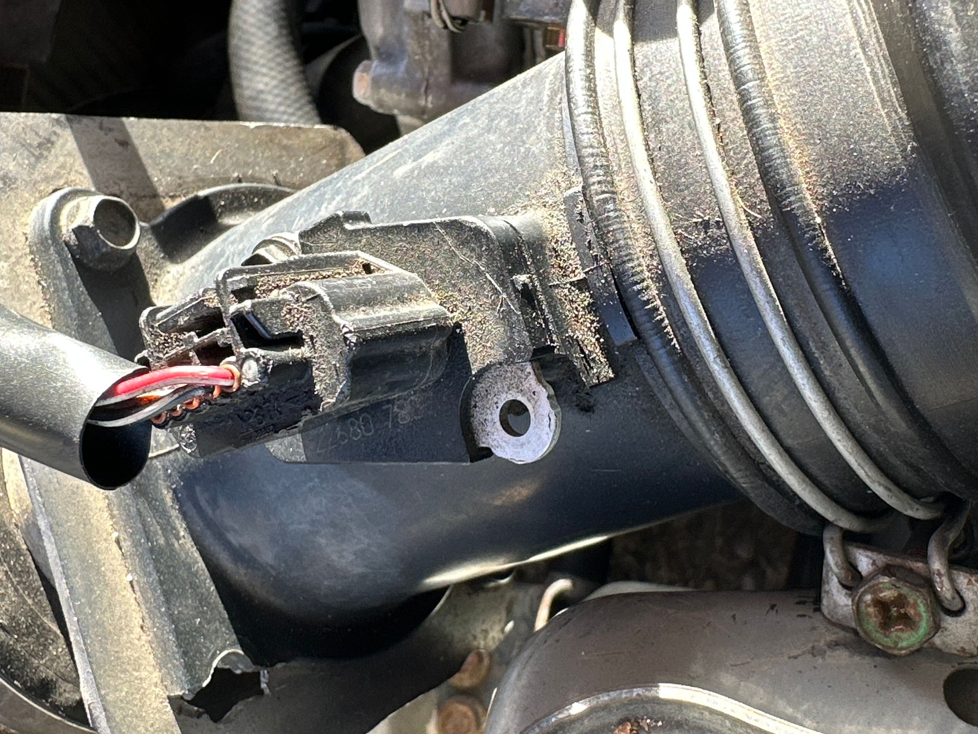

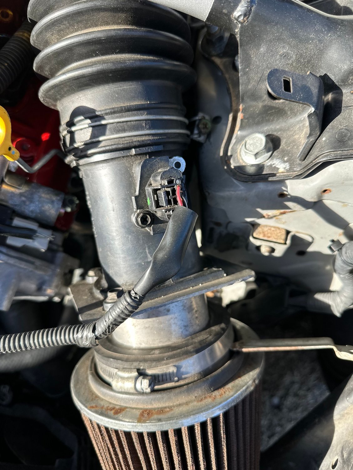

My thoughts/what's been done: The PO replaced the throttle body (non-em, I believe he used the Dorman 977-563 which Im not sure was a better choice over oem) and a new gas pedal and throttle position sensor. He never did the re-learn procedure for the idle/ecu, so I have already attempted disconnecting the neg terminal on the battery for 20+ mins, doing the re-learn according to the service manual which will resolve the issue temporarily but it keeps coming back to haunt me. I believe I have completed the re-learn procedure at least 3 separate times now. My suspicion is that the throttle body is no good or that maybe the MAF could be causing this? The piece that the MAF plugs into on the MAF assembly is broken on one side which I suspect could cause an issue (pic attached).

broken portion of MAF housing

I’m not sure which specific issue you’re referring to, so I’ll cover a few of them
the chatter is most def coming from the flywheel which I haven’t dealt with yet
the power/accel issues were fixed when I replaced the MAF & MAF housing. The issue still comes back from time to time which i think is due to the fact I’m running an oreillys brand throttle body. Plan to replace with hitachi oem sometime in the future
