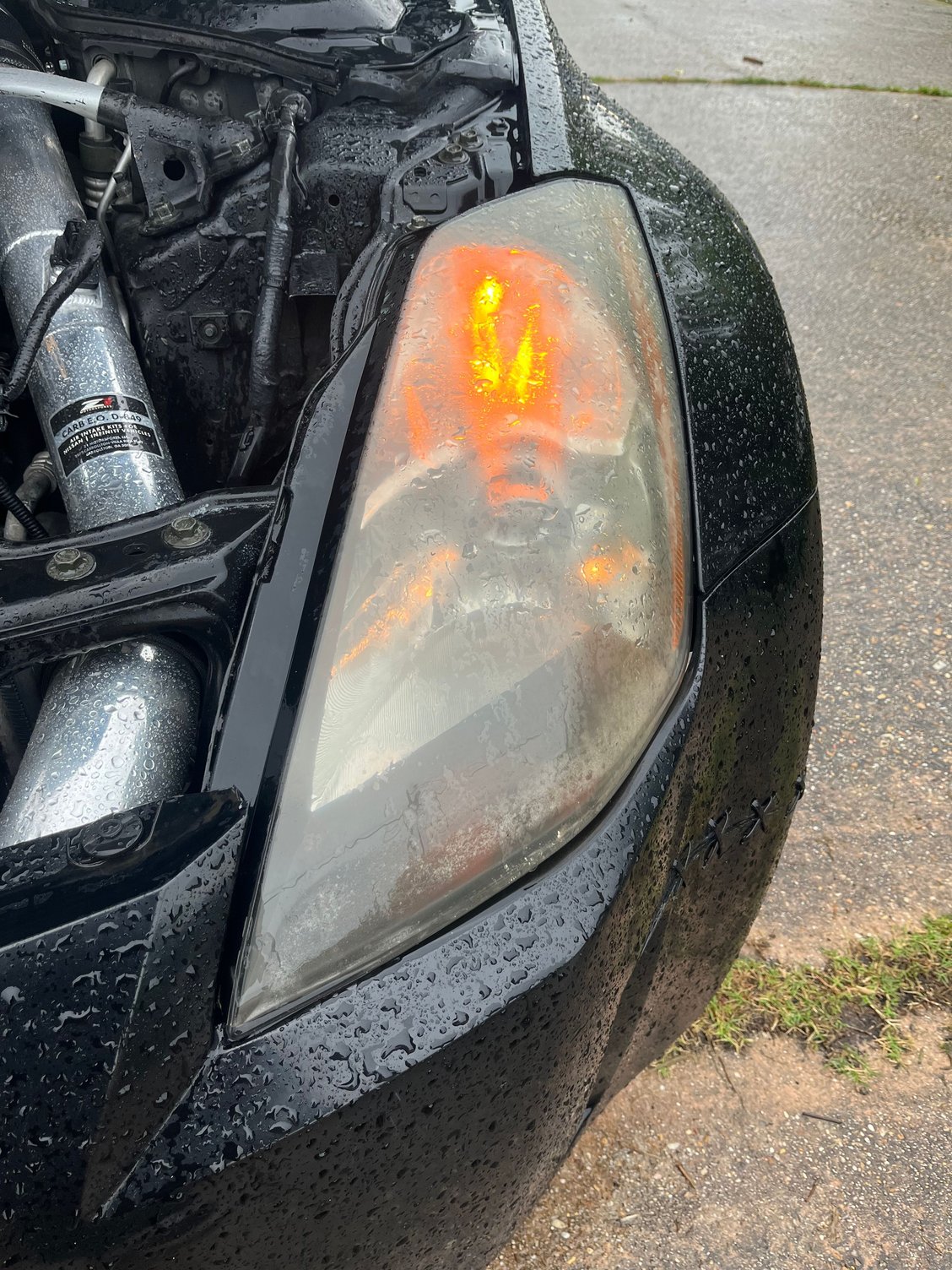

Got a question:
Ran over some water on my driver side and now the low beam and high beam doesn’t turn anymore. Turn signal and daytime running lamps still work. Checked fuses and nothing blew.
Swapped bulbs and it still won’t turn on. So Im probably gonna assume I burnt the HID ballast?
Any experience with these issues would help.

I think it's a pretty safe bet the ballast is toast. If you wanted to be 100%, you could swap ballasts.
Do you have fender liners installed?

yes make sure you have fender liners installed or else this will keep happening.
