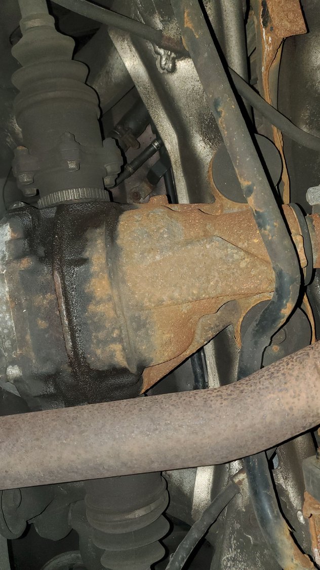

Hey all,
The car is a g35 2003 coupe. 6mt.
Not sure if its axle grease or diff fluid. its on both axles....
No drips on the driveway. This coulve been like so for years... I only noticed it today when doing some exhaust gaskets.
Anyone have similar leak?

Drain diff fluid, pull out stubs, replace seals, refill.

Top off fluid. Profit and fix when it gets worse
Stubs? Can you elaborate on this? I have the same issue.

"rear axle stub"
Nissan: OEM Differential Output Shaft Stub Axle
