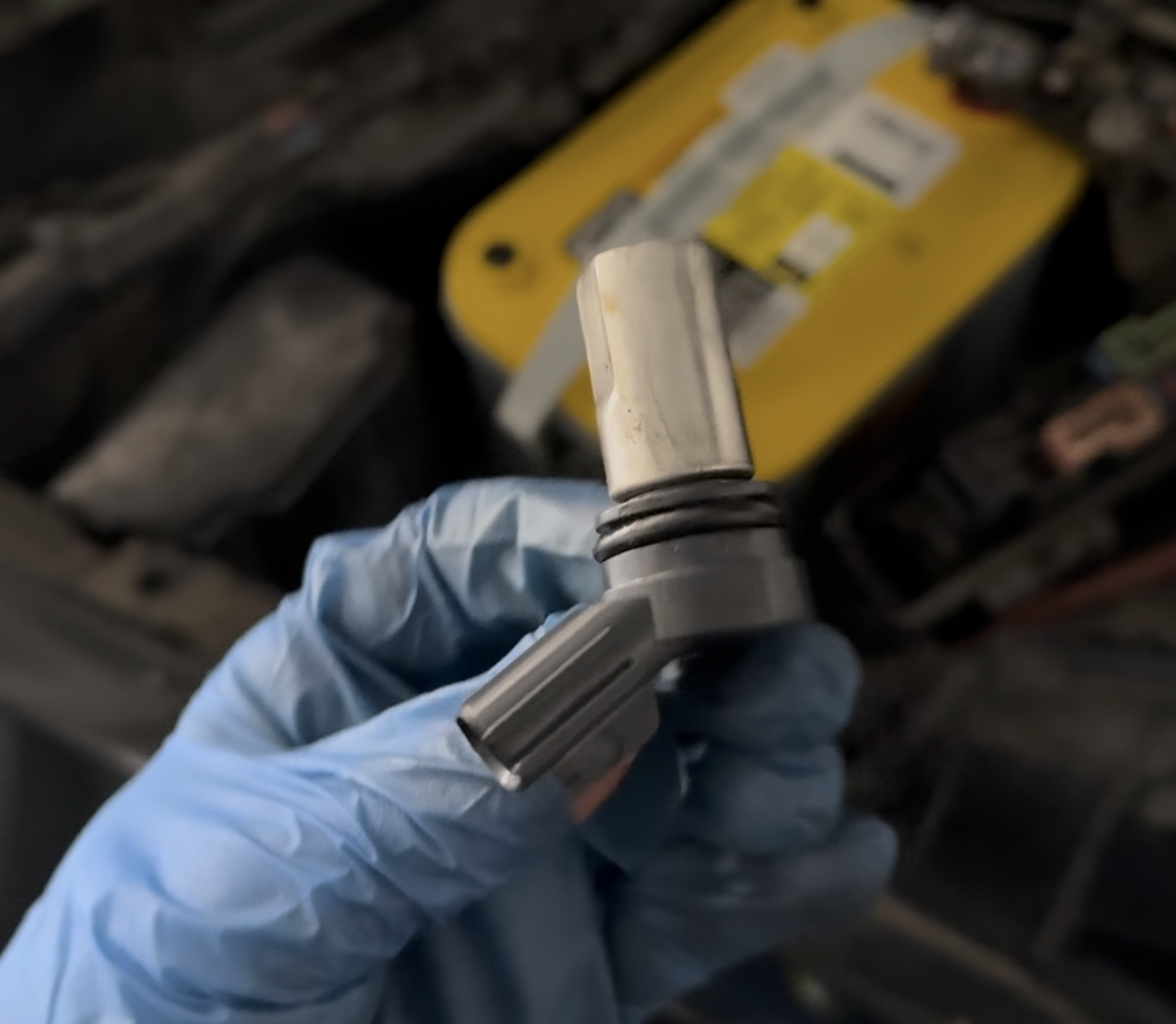

  • Visual Inspection: Visually inspected both camshaft position sensors and their connections to the harness
  • Sensor Testing: Tested camshaft position sensors using an INNVOA 3320 multimeter and a fresh car battery (making sure the battery was unplugged during sensor removal).
    • While the sensors were plugged in, I tested the signal wire to ground and waved some metal in front of them to watch voltage.
    • While the sensors were removed, I tested power to ground voltage of the harness, signal to ground resistance, and continuity of signal to ground.

Cam Position Sensor Inspection
  • Both sensors are aftermarket (silver metal)
*Shown in this photo of the driver’s side sensor
  • Appear visually undamaged
  • Harness connectors look undamaged
Multimeter Testing (INNOVA 3320, with good car battery)
Note: Multimeter capped at 12V
Passenger Side Sensor:
  • Signal-to-ground voltage: Initially read 0.7V then dropped to 0.2V and would rarely move even when metal was waved directly in front of the sensor
  • Power-to-ground voltage: 11.8V
Passenger Side Harness:
  • Signal-to-ground resistance: 9.94 ohms
  • Signal-to-ground continuity: No beep
  • Power-to-ground: 11.9V
Driver Side Sensor:
  • Signal-to-ground voltage: Constant at 0.2V; briefly jumped to 0.67V only once while I was waving metal in front of it
Driver Side Harness:
  • Signal-to-ground resistance: 9.9 ohms

Regarding sensors. You really should only use OEM sensors for your specific year. Aftermarket units are typically garbage. I don't trust those CAM sensors you have, I would replace with OEM. Always purchase from a reputable parts supplier. That means NO AMAZON or EBAY sensors unless you know how to spot the counterfeits.

In the meantime, I ordered both the left and right camshaft position sensors from RockAuto. I made sure to get the Hitachi ones. Here’s what I picked up:
  • HITACHI CPS0005 Camshaft Position Sensor – $42.99
  • HITACHI CPS0008 Camshaft Position Sensor – $42.79
Hopefully they arrive soon so I can get those swapped in.
